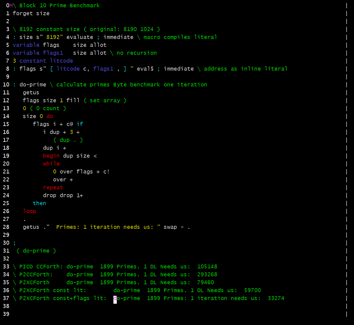

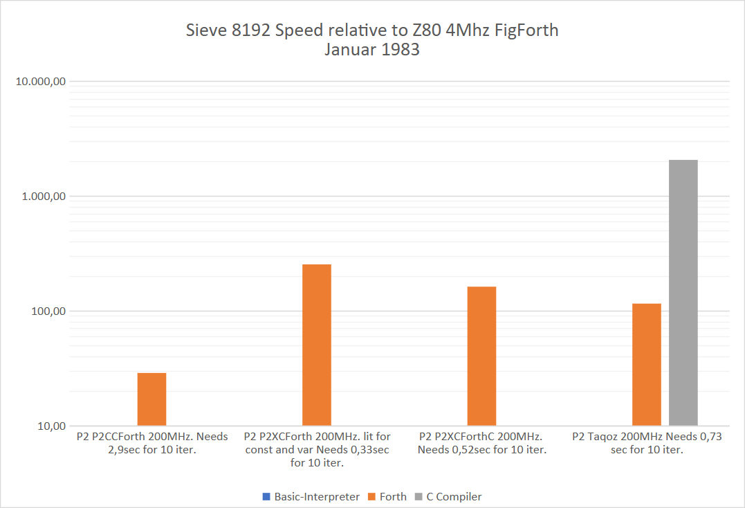

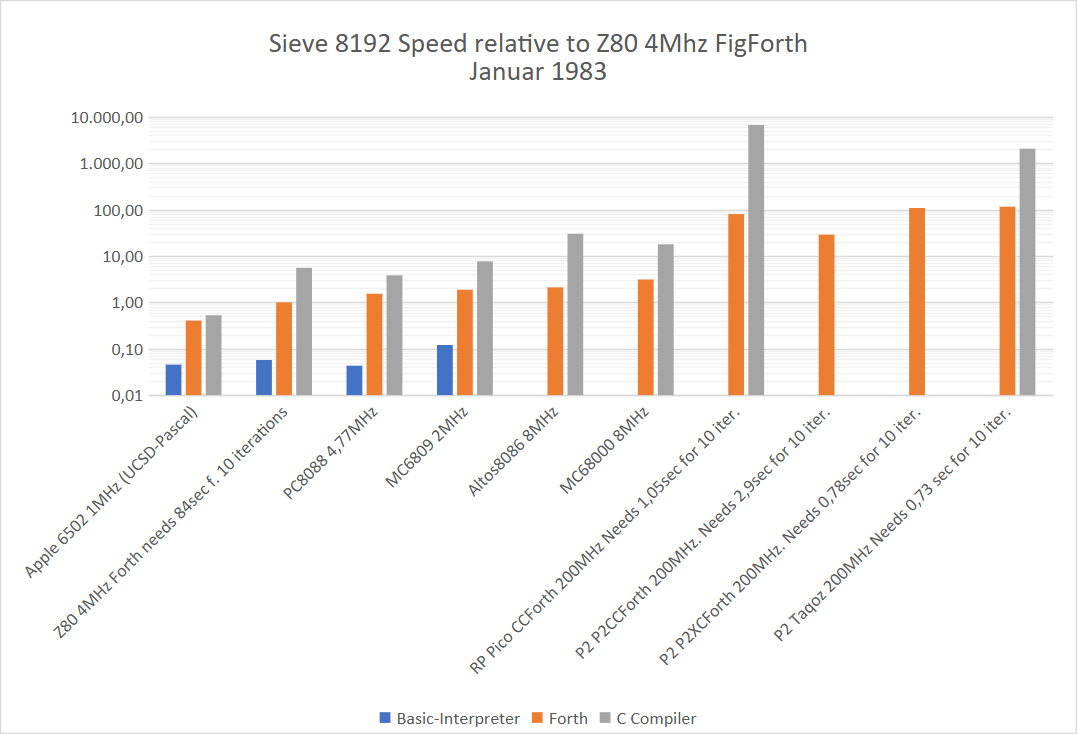

  • I think, that these difficulties about interrupts (executing hub code) together with any streamer action is the reason, that FlexProp does not support them. There is also probably a bug in Taqoz, when it is using the streamer for FILL, which could eventually be interrupted.
    About my Forth XBYTE machine, which is now able to execute hand-compiled code: Enough for the Fibonacci(46). Funnily it is almost exactly as fast as Taqoz, just a tiny bit faster, with the TOS in register, but the stacks in HUB. This is about 4 times faster, than P2CCForth! Without these hub accesses there should be some nice speedup possible against Taqoz. (But not for my actual mixed machine, because there is no room for the stacks in LUT. And how would you access a stack in LUT in C?)
    ROT is awful, 4 hub accesses:
    i_rot                   rdlong temp,ptrb[-1]    ' a b c -- b c a
                            rdlong data,ptrb[-2]
                            wrlong tos, ptrb[-1]
                            wrlong temp,ptrb[-2]
            _ret_           mov tos, data
    What I really don't like about XBYTE, is this skip encoding in the table, which completely alters the behaviour of the code at some other place, totally obscuring things at both places. (Huh, and there are people, who say that Forth has a bad readability....)
