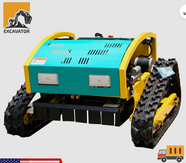

    Just in time.. my remote control tracked lawn mower arrives Friday. I haven't even seen one in person and already want to add a bunch of stuff!
    Thanks Jon!
