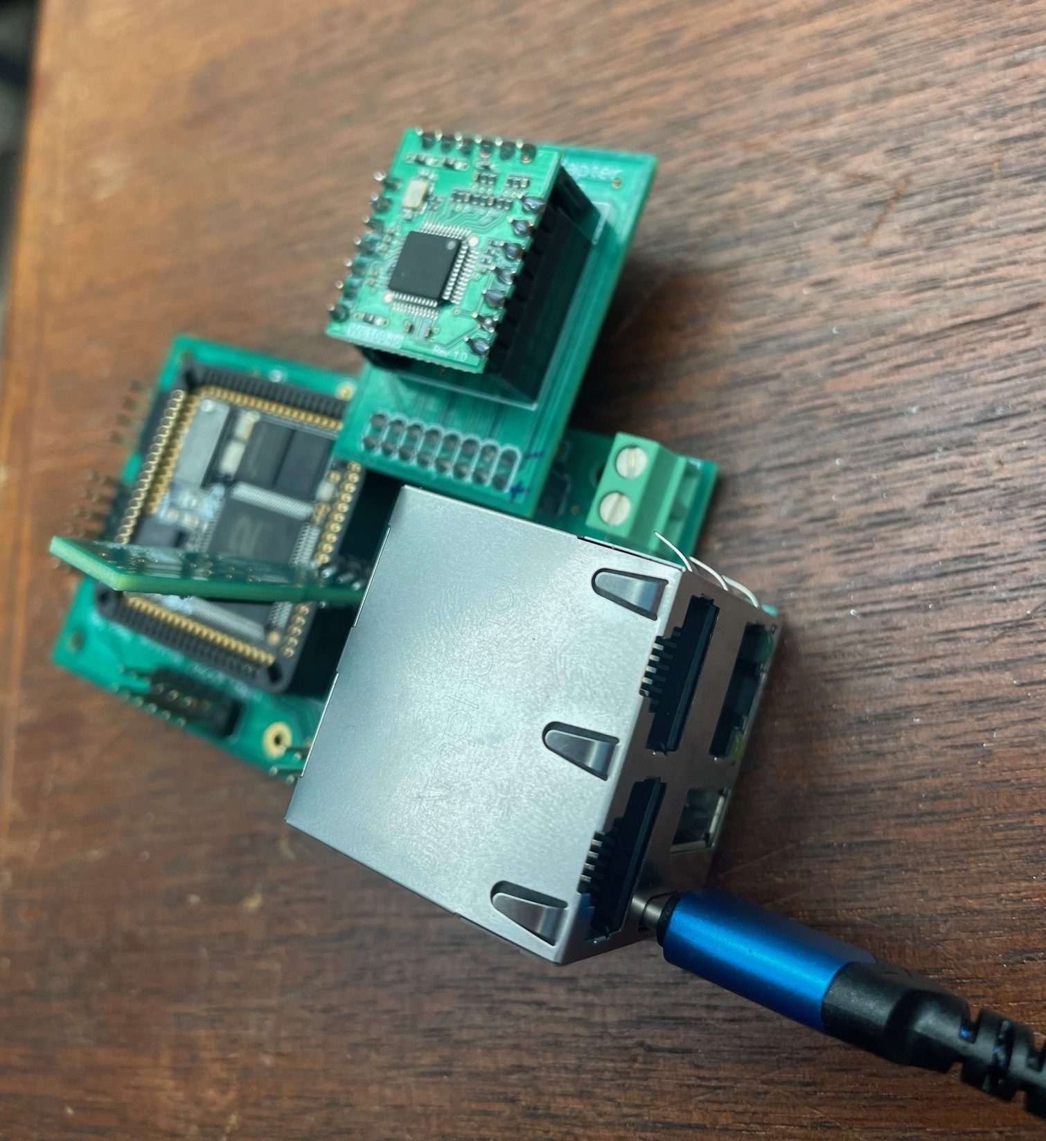

    Populated bottom board for the tiny 4771 board.
    Identifies with Prop tool, powered by USB-C connection, so that's good.
    Didn't really have space for pinned version of FT231X, so it needs Prop Plug for programming.
    But, there is an 8-pin port that connects to middle PCB.
    A future version of middle board could have an FT231X. Flip-flopping on this design decision though...
    This 4771 sized board basically has no space for I/O terminals, besides the USB-A and twin RJ-45 jacks.
    Guess the network jack could also be used one day when there's a daughter board to drive it.
    But, idea here is that if you need I/O could put this in the 4773 case and have 18 I/O terminals or the 4774 and have 36 I/O or the 4778 and have 56.
    You'd probably need I2C expanders for that though.
    Still, there are two Eval style ports on one side that could directly connect 16 P2 I/O pins to another board, sideways.
    And, the other side has a bank of 8 I/O pins in a single row.
    So, maybe this board is more flexible, but not as straightforward as the 4775 based board with built in I/O terminals...
    One mistake is that the boards are a hair too long. They just fit, but with zero margin, so can't remove them without damaging the plastic tabs that hold it in place. Next revision will be 0.5mm shorter...

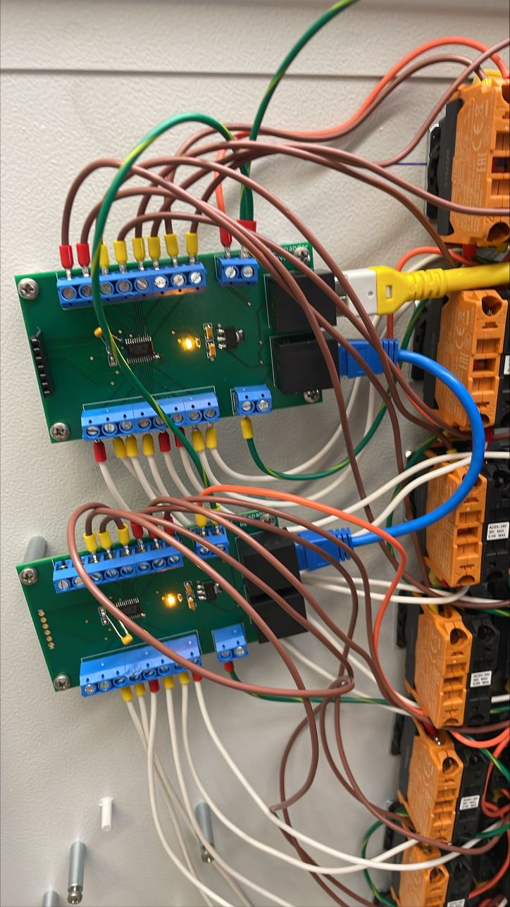

    Working on an I2C I/O expander pcb that can connect to one of the RJ45 jacks for signals.
    This should be enough for my application, but making it so they can be daisy chained if need more...

    Learned that doing i2c over a 10ft long RJ45 cable between the PLC and I2C expander board might not be a good idea...
    Was having kind of random issues with PCA9673 not always replying with ACK when addressed and doing other bad things when the inputs to the expander where toggled...
    The 10ft cable inside the box was way overkill anyway, just all had lying around.
    Replaced with ~1.5 ft cable and seems all better now.
    Thought that the problem might be that had forgotten to add bypass caps near the expander chip.
    Soldered some in, but that didn't help.
