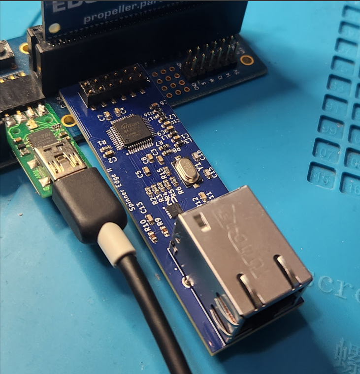

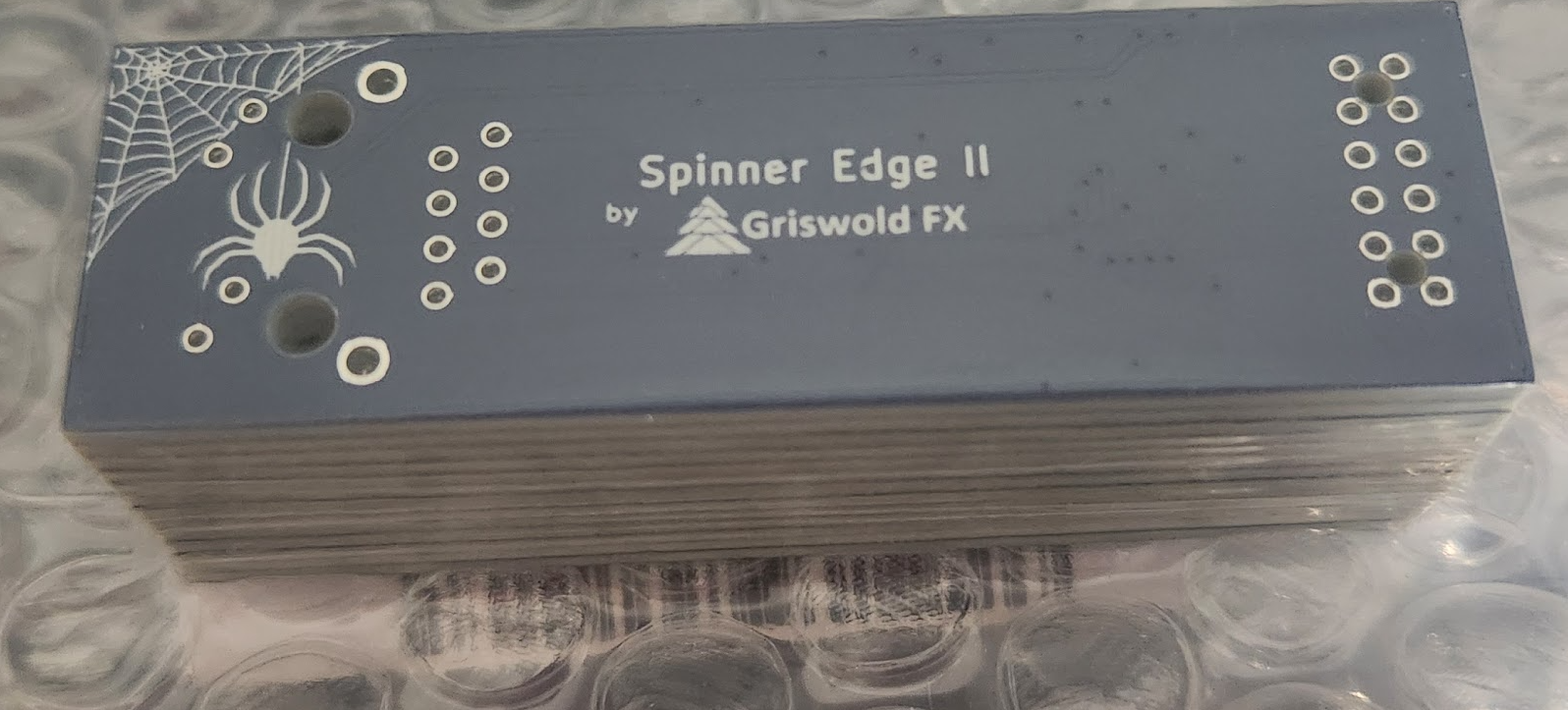

    The boards and all the parts have arrived. Hopefully I will have some time tomorrow night to make a couple of them. If anyone is interested in helping me develop a driver, PM me.
  • ke4pjwke4pjw Posts: 1,257
    Well, it's real. It gets link and activity, so I can assume the oscillator is running. I can also pull P7 low and it will reset. (Loses link and comes back when expected)
    Now I need to figure out how to do more than poke it with the proverbial stick :)

    Well, when I scope probe QD1, I do see data, but the SPI driver isn't returning data. I am going to throw the logic analyzer at this and see what's really going on with all of the pins. Based on the datasheet, I should send 3 bytes, all zeros, for it to be set to pull the chip version number, then read a dummy frame, and then I should get valid data.
    Instruction byte:
    bit 7-6 : 00 is single SPI mode
    bit 5 : 0 Read Access
    bit 4-0: 000_00 Common Register (Where the chip version lives)
    Address bytes:
    $0000 - This should be the address of CIDR0, the major ChipID.
    Read phase:
    Clock a dummy read byte.
    Clock a byte to get $0000 value (Expecting 00)
    Clock a byte to get $0001 value, (Expecting 61)
    All I get are $00 on the P2. Running the SPI in mode 0, which is valid for this chip.

    Sorry, I didn't see your request for help. The pin order you've chosen for 4-bit wide suits the streamer, not smartpins. I would have recommend using the streamer for 4-bit anyway. It is a little tricky but you get benefits for the effort. But we'll get to that after having success with 1-bit SPI mode first.
    Okay, 1-bit SPI operations:
    • Operating smartpin P_SYNC_TX mode (%11100) has it's sequencing tricks. Start-stop and continuous update modes have a subtle difference in initiating. In continuous mode, X[5] = 0, if you raise DIR before loading Y with the data then it will send all zeros for the first word. Whereas in start-stop mode, X[5] = 1, it works entirely on clocks for buffering, DIR is ignored I think.
    • Another area to pay attention to is clocking a tx smartpin for sync serial. If you're working with a small clock divider - usually the case - then the Prop2's I/O staging latencies will need to be compensated for. It differs depending on the divider value in use. In the clock smartpin setup, either P_PULSE (%00100) or P_TRANSITION (%00101), what WXPIN value are you using for the divider right now?
    • Rx sync serial smartpin mode, P_SYNC_RX (%11101), should be the easy part. It doesn't have to worry about I/O staging latencies since the incoming clock and data signals follow matching paths. Set the word length is about it. Then just have to look for IN high and use RDPIN to clear the buffer, returning IN low.
    EDIT: Oops, it's worse than I thought! The tx smartpin, in P_SYNC_TX mode, can't be internally routed for the clock pin. The two pins are too far separated at the Prop2. :( Unless you're into cutting tracks and pin jumpering, you're locked into doing streamer ops straight off the bat I'm afraid.
    PS: A pin order that could have done both streamer and 1-bit SPI would be:
    So, it looks like this was a hardware problem. The 1.2V had a low resistance on C4 and was causing the Wiznet to fold back and reboot. I am guessing this was solder that didn't fully melt or some debris made it's way under that component. It was showing shorted to ground. Luckily I only had to remove two caps to find the problem. Swapped out the Wiznet just to ensure it wasn't damaged. Now I can read what I expected!! W00T! Spent way too much time on something stupid. I want one of those PickSoEasy PSE-3000's. This stuff is microscopic!
