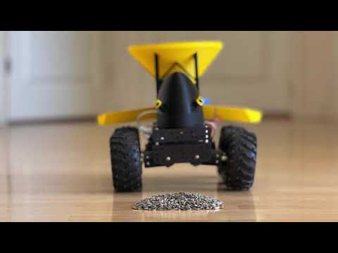

  • banjobanjo Posts: 462
    FWIW the end result is now published as a blog post at https://www.particle.io/blog/how-to-build-an-ice-curing-rover-with-particle/, full write-up at my Github repository.
    In the end I completely swapped out the Project Board for the Particle Photon 2 to keep the rover as simple as possible. But the Wild Thumper was sold by Parallax to another forumista (from whom I purchased it in 2017), so still pretty much Parallax related 😀
    Many thanks again to all who helped me, especially @JonnyMac for your insights and support! Any and all mistakes are purely on me, in addition to them, I learned a lot along the way. I have loose plans to do something more with the rover during the summer, probably something AI-related this time, time will tell.
    The "music" in the video is something I asked ChatGPT and Suno to compose, quite awful result, but then I also spent max 5 minutes on it.
