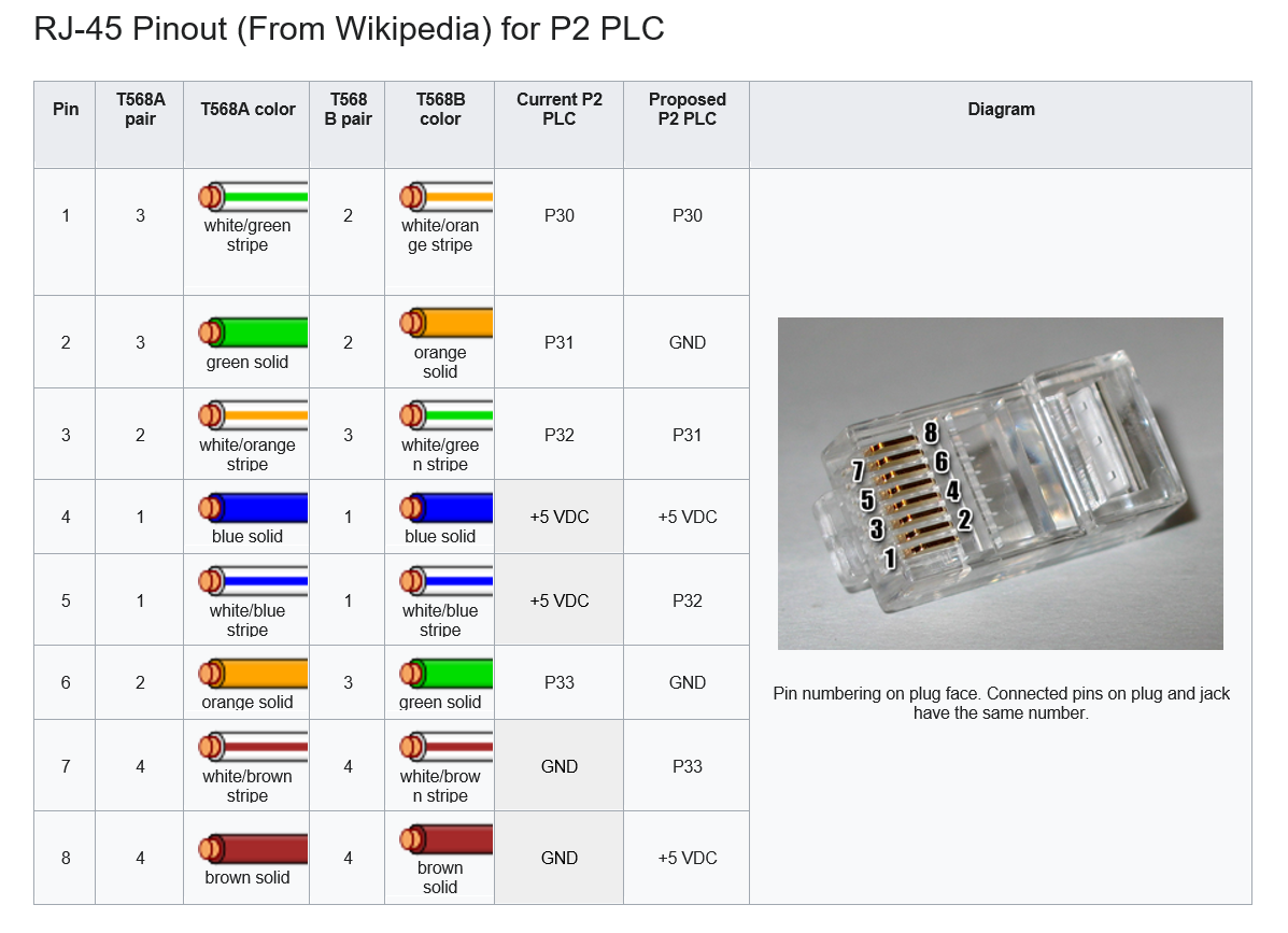

Learned that doing i2c over a 10ft long RJ45 cable between the PLC and I2C expander board might not be a good idea...
Was having kind of random issues with PCA9673 not always replying with ACK when addressed and doing other bad things when the inputs to the expander where toggled...
The 10ft cable inside the box was way overkill anyway, just all had lying around.
Replaced with ~1.5 ft cable and seems all better now.
Thought that the problem might be that had forgotten to add bypass caps near the expander chip.
Soldered some in, but that didn't help.
But reminds me that I'm not entirely onboard with the PoE pinout for RJ-45 that has two grounds on a twisted pair, two 5V on another pair, and 2 pairs of P2 pins on the other pairs.
If each P2 pin was paired with either gnd or 5V, then could use PCA9600 in the best way.
Still, maybe PoE style pinout buys something that am just not seeing yet...
Ethernet 8P8C pinning is for 2V differential signalling to allow common mode rejection of noise. The PoE extension of that can use the same two pairs, the “spare” pairs only, or all four pairs to transmit DC power independently. As you are not using these signalling and supply schemes there’s no benefit in simply replicating the pin use.
The EIA/TIA-568 pinout of the 8P8C connector for Ethernet was inspired by telephony cabling standards (including RJ-11, RJ-12, and RJ-45 connections) to take advantage of existing cabling infrastructure to implement Ethernet more cheaply. It sounds like you are free to allocate the pins and pairs any way you like, although varying the physical connections would require you to make your own cables.
Pairing single-ended signals with a ground reference is good practice, but I’d still keep the power separate from the signals.

Was just thinking that for RJ45 pinout might be better to pair p2 pin with either find or 5v to avoid crosstalk on long runs.
On the other hand, not really thinking about long runs at the moment…
@refaQtor Do you see a disadvantage to changing the RJ-45 pinout to the one described in previous post?
Thanks @AJL
Maybe wrong but thinking that a well bypassed 5v line is just as good as ground for a p2 signal pin to be paired with.
Thinking that what one should avoid is a twisted pair with two different high freq signals…
With a p2 pin paired with ground or 5v there is capacitance to worry about but not crosstalk…

Knock yourself out. (that's an odd expression, now that I write it down)... whatever you do, just make the pinout plain to users. I've been encountering many variations in serial pinouts over RJ45/RJ11/DB9/DB25 and keep a drawer of connector/converters to redirect pins between ends.
https://www.amazon.com/ANMBEST-Ethernet-Adapter-Modular-Converter/dp/B0CX8CLXHZ/ref=sr_1_4?sr=8-4
I chose that to actually move power down the conductors of a common and cheap cabling/connector components that had been historically, as I understand it, and primarily to move just signals. so, doubling up to move power, and since now there is PoE, it made sense for me. I never cared to do I2C or SPI over those external connections.
@refaQtor Thanks. Took a look at what this would look like... Want to make sure using a crossover cable wouldn't connect +5 VDC to a P2 pin...
