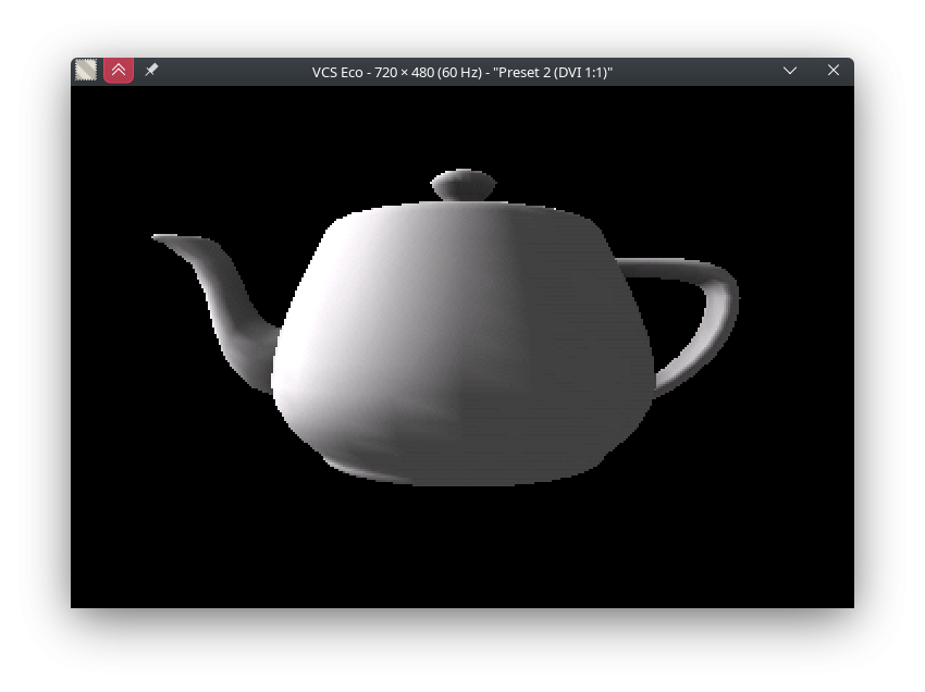

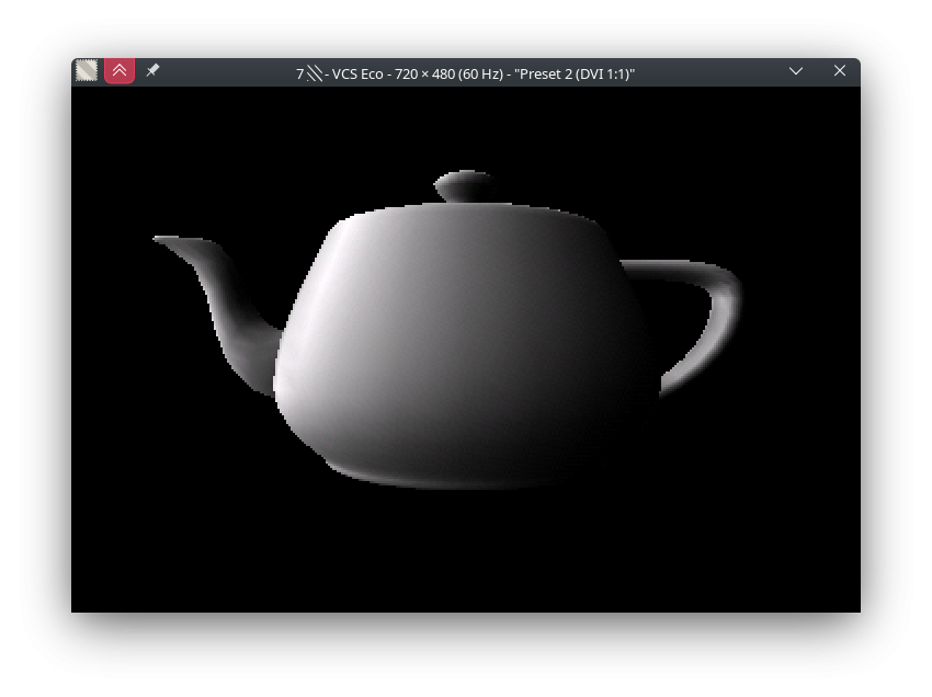

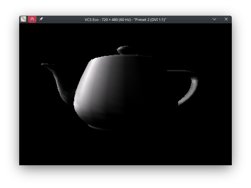

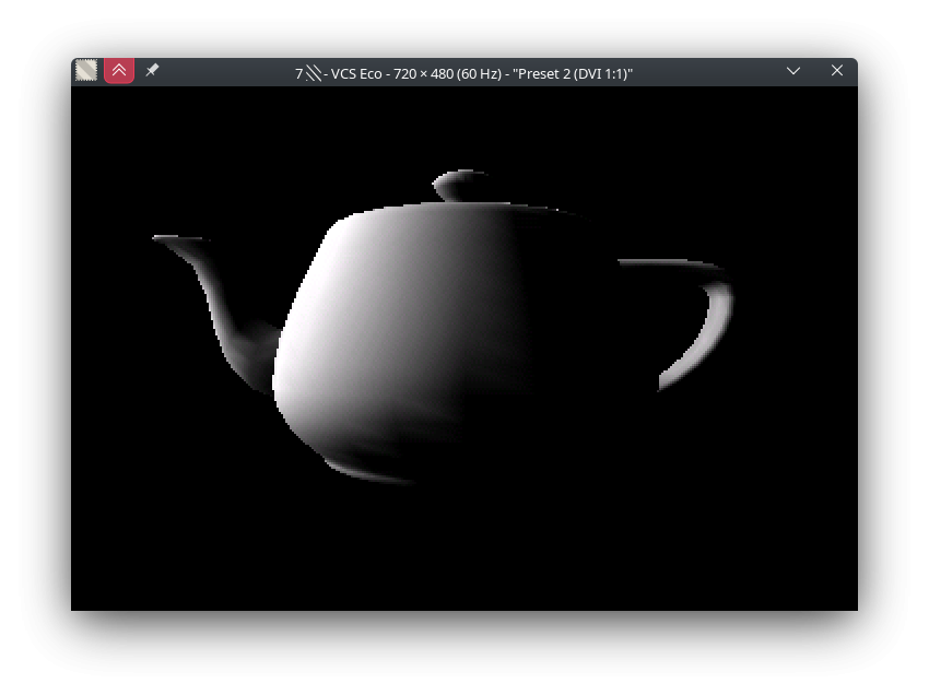

    Messing around with vertex lighting
    That required a whole detour into figuring out a rounding error that would cause white sparks to appear where the rasterizer disagreed with the L/Z gradient on where the triangle edge is. I don't think I 100% figured it out, but adding a bias to the gradient to stop it from underflowing is good enough.
    Different lighting term (source-style half-lambert) that looks less nasty:
    EDIT: Another variant: standard lighting term, but squared to sortof-account for gamma:
  • evanhevanh Posts: 17,142
    Good comparison. I don't think I've stopped to look at compares before. Hadn't considered it even.
    The middle one - source-style half-lambert - is the easy choice for view-ability. I guess it is kind of a fake ambient lighting effect, that provides an additional gradient on surface spread of light, or something like that?
  • Wuerfel_21Wuerfel_21 Posts: 5,817
    edited 2025-05-28 00:21
    The half-lambert idea comes from a presentation on shading techniques used in source engine (check slides 25 onward).
    Usually you'd have some constant (or vaguely directional) ambient light value to avoid the back side being completely black, but I didn't do that for those screenshots. The half-lambert function lights even the back side somewhat, so less of that is needed and the shape of the object is clearer.
    The actual functions:
                  ' dot product
                  scas vt_ntx,geo_littest_x
                  mov tmp1,0-0
                  scas vt_nty,geo_littest_y
                  add tmp1,0-0
                  scas vt_ntx,geo_littest_z
                  add tmp1,0-0
                  {' normal
                  fges tmp1,#0
                  shl tmp1,#1
                  add vt_light,tmp1
                  {' normal + gamma approx.
                  fges tmp1,#0
                  scas tmp1,tmp1
                  add vt_light,0-0
                  '{' half-lambertian
                  add tmp1,g_con7FFF
                  sar tmp1,#1
                  scas tmp1,tmp1
                  add vt_light,0-0
            _ret_ fle vt_light,g_conFFFF
    (at the end this is still multiplied by the baked AO shade from the model data)
  • One problem with the half-lambert approach is that the light intensity can't be controlled just by changing the length of the light vector.
    For a more fair comparsion, this is the "normal" one with reduced intensity and ambient light:
    That sort of thing is very representative of a particular era of fixed-function T&L.
