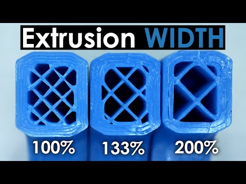

Here is a rundown on part strength as a function of layer height:
And those blobs a lot of people see on their prints? This one actually has a lot of technical detail shown in context.
This is a topic close to my heart. Part strength. In general, infill contributes very little to part strength. Failures come from stress and or strain, both of which happen at the exterior surfaces of a part. Longer, continuous chains of polymer, coupled with more mass at the failure areas, combine to make a very significant improvement in part strength. Many would increase infill, perhaps making a part solid, which can improve a part, but not for the most common failure modes.
And a controversial one! Less part cooling = stronger parts.
This also means more ugly parts, but the message with 3D printing in general is the whole affair is a game of trade-offs. In my nice parts above, the trade-off was print speed being traded for part integrity and overall surface quality.
