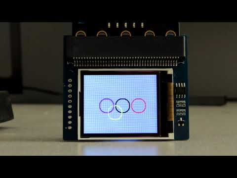

Test Code
# Circle.py
# TFT-LCD demo
from microbit import *
import math
from TFT import LCD
spi.init(baudrate=10000000, bits=8, mode=0, sclk=pin13, mosi=pin15, miso=pin14)
WHITE = 0xFFFF
BLACK = 0x0000
BLUE = 0x001F
RED = 0xF800
MAGENTA = 0xF81F
GREEN = 0x07E0
CYAN = 0x07FF
YELLOW = 0xFFE0
GRAY = 0x9492
lcd = LCD(spi)
lcd.init_lcd()
lcd.set_backlight(1000)
lcd.clear(GRAY)
def draw_circle(center_x, center_y, radius, color):
for i in range(360):
rads = math.radians(i)
x1 = center_x + math.sin(rads) * radius
y1 = center_y - math.cos(rads) * radius
lcd.draw_pixel(int(x1), int(y1), color)
draw_circle(50, 68, 15, BLUE)
draw_circle(50, 68, 16, BLUE)
draw_circle(85, 68, 15, BLACK)
draw_circle(85, 68, 16, BLACK)
draw_circle(120, 68, 15, RED)
draw_circle(120, 68, 16, RED)
draw_circle(68, 83, 15, YELLOW)
draw_circle(68, 83, 16, YELLOW)
draw_circle(105, 83, 15, GREEN)
draw_circle(105, 83, 16, GREEN)

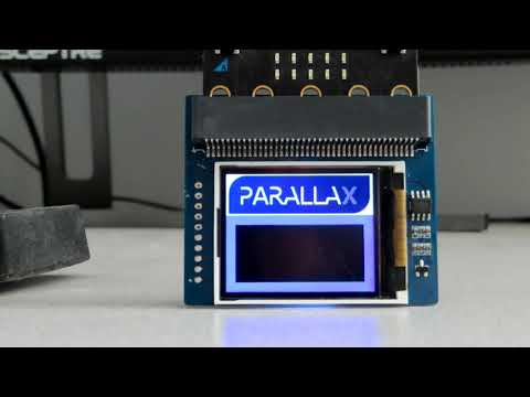

3 Images and Utility
With the information we have so far we can initialize our LCD and draw some graphics maybe even create a few stick fonts. Images take things to another level and over the next two posts I would like to show how we can display our own images. First we need somewhere to store the images so using the Waveshare microbit device I will use the onboard SRAM.
This will involve extracting the image data from an image file and saving this data to a new file. Then we can use our micropython editor to read and write this new data file to the SRAM memory.
There a a couple of things to consider before we create this new file. First lets keep the file size below 15 Kbytes so that we dont run into out of memory issues with the microbit. The number of bytes our file will be is proportional to the number of pixels our image has. Here are two examples, the first image is 160 pixels wide and 45 pixels high, 160 x 45 = 7200, there are two color bytes for each pixel so the final file size for image 1 is 14400 bytes which is within the 15 K range, the second image is a full screen 160 x 128 which equals 20,480 pixels so that is 40960 bytes, way over limit. There are ways to get around this but for now lets keep within the 15 K range.
The microbit micropython editor won't be able create the new image data file so you will need to run the following code on a computer that has the full version of Python.
Usage is straight forward, I try to stick with source files that have the .png extension and I usually name the destination file with the .bin extension.
The following code is very basic so keep source and destination files in the same folder as the utility, there is no need to type in the full path. The libraries used in the app are very common modules and most come packaged with Python.
Utility
from tkinter import * from tkinter import ttk from tkinter import messagebox from PIL import Image import numpy as np root=Tk() screen_width= root.winfo_screenwidth() screen_height= root.winfo_screenheight() root_width=270 root_height=150 x_location=(screen_width/2) - (root_width/2) y_location=(screen_height/2) - (root_height/2) root.geometry(f"{root_width}x{root_height}+{int(x_location)}+{int(y_location)}") root.title("Data from Image") root.resizable(False,False) var_list=[] source_var = StringVar() destination_var = StringVar() def get_params(): source_var=source_entry.get() destination_var=destination_entry.get() var_list.append(source_var) var_list.append(destination_var) create_img_data(var_list) def rgb_hex565(red, green, blue): return "0x%0.4X" % ((int(red / 255 * 31) << 11) | (int(green / 255 * 63) << 5) | (int(blue / 255 * 31))) def create_img_data(var_list): var_list=var_list src_file=var_list[0] destination=var_list[1] if src_file=="" or destination =="": img_msg() return try: bin_img = Image.open(src_file) except: bad_file_msg() return img_map = np.array(bin_img) f = open(destination, 'wb') for y in range(bin_img.height): for x in range(bin_img.width): pix_color=img_map[y][x] value = pix_color[0] value2=pix_color[1] value3=pix_color[2] newcolor=rgb_hex565(value,value2,value3) bin1=int(newcolor,base=16)>>8 & 0xFF bin2=int(newcolor,base=16) & 0xFF f.write(bin1.to_bytes(1,"big")) f.write(bin2.to_bytes(1,"big")) f.close() messagebox.showinfo("Info", "File Operation Completed") close_app() def img_msg(): messagebox.showerror("Error", "Source and Destination must contain a valid filename") def bad_file_msg(): messagebox.showerror("Error", "Source not found") def close_app(): root.destroy() def on_closing(): if messagebox.askokcancel("Quit", "Are you sure you want to exit?"): close_app() root.protocol("WM_DELETE_WINDOW", on_closing) btn_CreateFile=Button(root,text="Create File",width=10,command=lambda:get_params()) btn_CreateFile.grid(row=4,column=1,pady=15,sticky='w') btn_Exit=Button(root,text="Exit",width=10,command=lambda:on_closing()) btn_Exit.grid(row=5,column=1,sticky='w') source_entry=Entry(root) source_entry.grid(row=0,column=1) destination_entry=Entry(root) destination_entry.grid(row=1,column=1) lbl_source=Label(root,text="Source File",pady=10,padx=20) lbl_source.grid(row=0,column=0) lbl_destination=Label(root,text="Destination") lbl_destination.grid(row=1,column=0) root.mainloop()Loader
Hopefully you now have a binary file containing the data for your image. I am posting here the micropython code we need to write the image data file to SRAM, I will refer to this code as the "Loader", also I am posting a small micropython code to test the success of loading the image to SRAM.
As long as we maintain power to the microbit and don't over write the image data we can switch between program sketches and access our image at any time.
I will describe the actions in a step by step fashion and hopefully it will be easy to understand.
step #1 Remove all files from the microbit file system
step #2 Copy the image file (mine is called logo.bin and is 14400 bytes) onto the microbit file system.
step #3 Close the file system and copy the "Loader" code into the micropython code editor.
