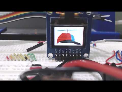

    I would appreciate some help in someone pointing me to where to read in the P2 manual about smartpin transfer speeds. I was under the impression that the smartpins were bound to the clock speed. This one is operating at 24KHz.

  • This is sync mode. My reading of this would indicate that at 160MHz, outputting a byte would be sending data at about 20Mhz. (Two clock cycles per bit at 160Mhz = 80Mhz. Only sending 8 bits (1/4th of 32 bits) lands me at 20Mhz. And I am not sure about that last bit. Either way, it should be way, way higher than 24KHz.

  • evanhevanh Posts: 17,060
    Aww, looks a little out of control there. System clock setting is probably not working to requested speed with that 640 MHz setting in the the source code. The measured 24 kHz bit rate would indicate the system clock is likely around 200 MHz.
    I calculate the above from 24000 x 4096 x 2. The 2 is because two clock transitions per bit. 4096 because that's the transition period set on line 468 of test_AsmDrv.spin2.
    As for the system clock setting. You've made an error in comments of _XDIV, a value of 2 gives 10 MHz, not 5. This has caused incorrect calculation for the other components. Also, I'd recommend leaving _XDIVP = 1 unless going below 20 MHz. I know the docs say 100 MHz but that's a hugely conservative number.
  • ke4pjwke4pjw Posts: 1,277
    edited 2019-02-26 05:34
    I got a moment to work on it again this evening. Thanks for pointing out the problems in the code. I have updated the code to run the P2 at 320Mhz. Bitclock is now running at about 12Mhz. As we say down south, "It runs like a scalded dog!".

    PS: I updated the video so you can see the end result. We might be able to implement a screen buffer on this bad boy! It's fast!
  • I am having too much fun with this. We have enough RAM and data throughput with the P2, we can animate.
