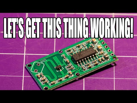

    My new favorite sensor is this dirt-cheap ($5 for 5pcs on Amazon) RCWL-0516 Doppler microwave sensor. I have one inside my office door, it senses outside people THROUGH the wooden door and triggers two LED displays to greet them. I have the output switching a logic-level mosfet for several seconds, and the module can be continously retriggered by more motion. At 5V, the sensor-only draw is just 1-2 mA so a battery would last a long time as long as the triggered load doesn't drain power too fast.
    Not the best video but it inspired me to try the sensor and I had immediate success compared to this Youtuber!
