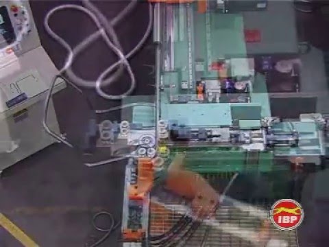

  • @JRoark said:
    Sounds like fun! This is for industrial machine control?
    Yeah, this is the very machine when running on my old DOS control. I used to supply these guys ~100+ controls/year. Now they are gradually dying-off and I am re-controlling them because mechanically, they are still in great shape.

  • @Mickster Based on what I see at 4:35 in that video, you play with machine control for people who make giant paperclips!
    On a serious note, that is really cool. I hope you make a MINT with the P2!
