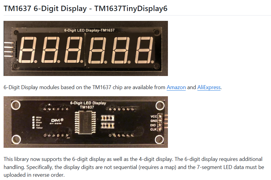

    Just received and tested this 6-digit display
    -- https://www.amazon.com/Display-Digital-Decimal-Segment-Module/dp/B0B2DJ62KD
    DO NOT PURCHASE. This display is not mapped like others so anything my driver sends to it gets scrambled.
    Other displays: [0][1][2][3][4][5]
    This display: [2][1][0][5][4][3]
    I should have paid attention to the first review for this module which says the TM1637TinyDisplay6 library must be used (for Arduino). Looking into that driver, it has the ability to remap the user data so that it works for this display. For most projects I will use the clock-type displays, so I'm not going to add remapping to my driver. I have one of the 6-digit displays shown in the first post and it is mapped properly.
  • JonnyMacJonnyMac Posts: 9,733
    edited 2025-12-09 16:50
    Final post on this topic. Since I had to solder a header to the display to use it I cannot send it back, so I thought I should show those interested how to remap the output. The process is simple: turn what you want to display into a string and then use the .set_char() method to move a character from the string to a column in the display. The 3rd parameter enables bit 7 which is a decimal point or colon, depending on the display module.
