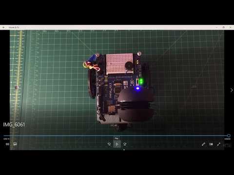

I have the BlocklyProp program loaded into Activity board WX and it will not play songs.
The same setup will play when I use a spin program.
I tried attaching an empty If forever block - failed to play
I attached the initializing block - failed to play
I have a blinky for ever program with wav play - failed
I have attached one of the failed blockly programs.
I need help to get the wav player started.
Siri

  • Ken GraceyKen Gracey Posts: 6,460
    edited 2019-03-12 - 19:54:44
    There's a subtle necessity about using the wav file playback blocks.
    Please see this http://learn.parallax.com/support/reference/propeller-blocklyprop-block-reference/audio and note that the code launched by the wav playback block starts another processor. The main processor must continue running for at least part of the duration of the wav file, else you'll get a buzzing sound when the main processor stops.
    Here is an example of a project that works, because of the PAUSE 5000 block being present after the wav playback block.
    http://blockly.parallax.com/blockly/editor/blocklyc.jsp?project=86767#
    // ------ Libraries and Definitions ------
    #include "simpletools.h"
    #include "wavplayer.h"
    // ------ Main Program ------
    int main() {
      sd_mount(22, 23, 24, 25);
      wav_volume(7);
      wav_play("techloop.wav");
      pause(5000);
      wav_stop();
    Maybe start with this, using the techloop.wav file on our web site and see if you can get it to work.

  • Siri, we checked your wav files today and found that the sample rate was off, but the format was correct. This would likely cause the library to play a "click". The wav file creation must follow our instructions exactly. https://learn.parallax.com/reference/create-audio-files-wav-players. Any deviation will cause the file not to play back (at least with the library we are using).
    For this reason, I suggested that you eliminate the speaker/SD card/file formats as the problem by using a wav file created by Parallax available from our library https://learn.parallax.com/support/reference/sound-library
    When things don't work right, back up a bit. Remove unknowns and simplify.

  • msiriwardenamsiriwardena Posts: 198
    edited 2019-03-14 - 13:29:29
    @Ken Gracey
    Ken,
    Your solution worked well, only mistake I\I
    made was my pause was too short , so it played
    few notes then I realized the issue.
    Thanks a lot helping me
