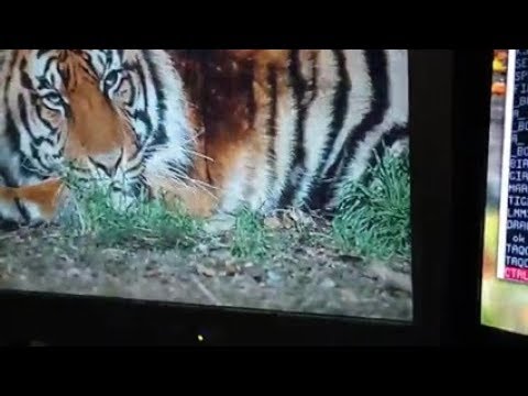

    I've been playing with adding in VGA into TAQOZ which I compile for testing out of P2 RAM and it seems to be working well so far. I'm fixing up any bugs and adding new features with a view to seeing what I can cram into the new ROM. I am able view load bmp files easily and I would like to add vga text as well although I know that the font table won't fit. I really wish we could have a 32k ROM but maybe I will design TAQOZ so that it automatically extends itself if it finds support in the Flash or SD. Then again, it is just as easy for it to load a new version anyway.

    Playing with the VGA at 200MHz clock.

    That's neat, Peter. Were those files on an SD card?
    edited 2018-10-23 03:09
    Yes, the video is a bit rough but you can see I did a DIR from TAQOZ and I cheated a little bit in defining TIGER as : TIGER $22440 VIEW ; etc but that is in anticipation of having TAQOZ searching the SD card automatically for when it doesn't find the word in the dictionary. So TIGER would fail a dictionary search and then would scan the file directory and find a BMP with that name which would then associate the BMP with VIEW, all seamlessly!
    The SD read routine is still a bit slow because I had a problem with multiple block reads and just reverted quickly to a sector at a time version.

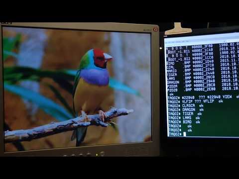

    Here a a few improvements to TAQOZ and VGA capabilities, mainly in reading the bmp file and also in the vga driver. The vga driver's palette and intensity are updated every vsynch.
    Also, I've fixed the camera in place for a clear view.
