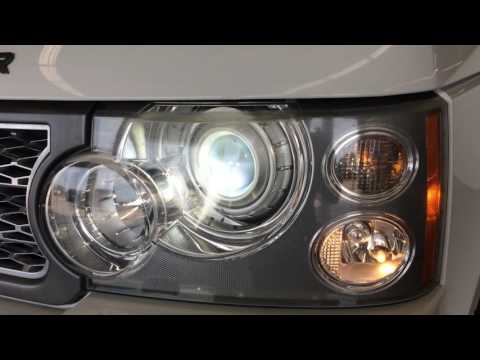

I have a headlight assembly problem and fault light. A little motor drivers a worm gear that rotates a headlight left<>right. The cheapest solution anywhere is to replace the entire assembly for 1750 US. There are not really any options unless you find a very rare used one which is still very high because of the demand. The motor has 4 wires, it is a very tiny motor that drives a larger gear attached to a worm gear. I have heard these can freeze up and people have solved it with lubricant and working it by hand, but in this case it moves freely. I can't tell what the motor is, it is very small. The bigger problem as far as diagnosing it is that once the fault light is on, the faults must be cleared by a special device just to get the assembly to do it's initial calibration on power on. If it fails on power on, the fault kicks back on and you must reset the faults to try to diagnose again. I just thought I'd see if anyone has messed around with these things before. I don't really care about the adaptive lights but the blinking fault light is driving me nuts.

    No it's on a Range Rover. Adaptive means they move around to track which direction the car is turning. I have abandoned this project and will have to get a new one. There is a control board inside the light, there is also the computer that must be dealt with to diagnose, and I don't have the system to reset errors. Basically it is far too complicated to work on. Even the dealers and local specialist shops say forget it. If it were possible to cost effectively repair these, it would be a good business. I found this video online for reference.

  • Try Ebay headlight level motor. More than likely a stepper motor. Range Rovers are Ok to buy or lease new used ones are a repair nightmare. That's why used ones are fairly cheap.
  • Look on Hella.com AFS says its a stepper
  • Like this one
