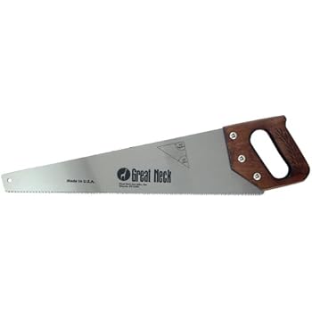

    I don't have many cutting tools: wire cutters, a drill, dremmel, hack saw, and big ol' hand saw along the lines of this:
    I have a soldering iron too... but probably shouldn't count that in my cutting tools :P
    Planks of ePVC look good though. A hacksaw blade would probably make reasonably quick work of that, and I could make holes for mounting with relative ease it looks like. I suppose angle brackets and the like could all be found Menards, right? Not sure where to actually find ePVC. None of the home depot's around me have this, but at least they can send it for free if I'm patient. 1/8" would probably be the right thickness right?
