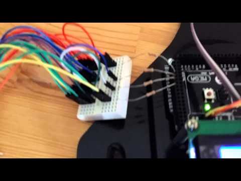

    Having fun with charlieplexing :smile:
    Do you remember Knight Rider? I was a big fan of the series, most notably the car named KITT. There was a red scanning light in front of the car where the grills are located. Why shouldn't my robot have one?
    You have probably heard of charlieplexing. Well, to put it in a nutshell, it is driving lots of LEDs with only a few pins. To be more specific, n pins can drive n2-n LEDs. Traditional multiplexing takes many more pins to drive the same number of LEDs. I have a few 10-LED bar graph displays waiting for their turn, I can use one of them. According to the formula, I can drive 10 LED with only 4 pins.[In reality 4 pins can drive (n2-n) -> (16-4=12) twelve LEDS].
    Below you will find my Arduino code for charlieplexing, also added a short video to give an idea of my "Knight Rider" light.

    Here are the circuit diagram, and a graph of connections:

    Sweet! Everybody loves blinking LEDs & Knight Rider. Alternatively, use a 74LS154 4-to-16 decoder chip to control 16 LEDs using 4 pins. Here's one I did with a 3-to-8 decoder chip (3 lines driving 8 outputs), 7 LEDs and one 5V beeper.
    https://www.youtube.com/watch?v=sm8K6dI8niA & https://www.youtube.com/watch?v=NMX5kicEoJw
