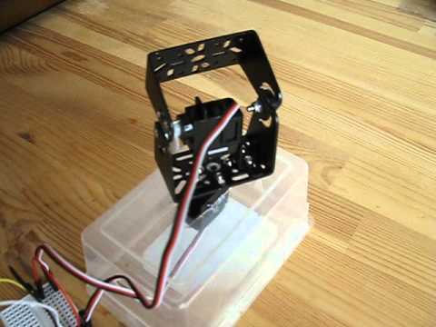

  • mrmamrma Posts: 28
    edited 2013-09-19 05:34
    Here is the pan/tilt mount running on Arduino, I'll put the CMUcam5 on this one. I've been considering to use the HiTec micro servos (HS-55) with this mount kit, but the servo arm horns do not match with the kit, so I got two ROB-09065 from Sparkfun, the circular mount fits just well to this mount kit. To help the beginners to the Arduino I also listed the code below,

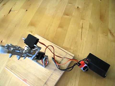

    edited 2014-03-02 04:27
    Thank you very much for your nice words, they are really motivating. :smile:
    I've made the piece that I mentioned in my previous post. It's a simple U shape aluminum to connect the claw to the pan/tilt bracket.
    Then, I mounted the claw on a test platform to see how it works. In the video you'll see that a servo tester in automatic mode tilting and opening the claw.
    Will this be able to lift up a softdrink can ? Not sure yet, we'll see.
