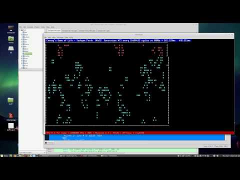

    A few years ago I wrote a version of Conway's Game of Life to display on a serial terminal. Here it is again revisited with some extras running under Tachyon V4 of course.
    Get the code in the Tachyon V4 folder
    This is part of the code that processes the keyboard shortcuts you can use to interact with it:

    I couldn't resist speeding up and improving the Game of Life, now with a touch of color. So much better that way, don't you think?

  • Yes, it's doing about 15fps on a 64x32 but slows down to 11fps on the 128x32. The screen update is desynchronized from the generation update in this demo but at 64 wide the next generation takes about 77ms, still room fro improvement though.
    I know this is off topic for this thread but do you know if anyone has done a PASM version of Life that runs on all 8 COGs at once? Or maybe 7 with one driving VGA?
  • In the LIFE demo I treat the universe as a shingle on which to print text using the Propeller font. So I went one step further and made it autoscroll and display when it reaches the right hand side so that it works like a character LCD. Just select the width and make it an output device and all Tachyon character output is directed to the shingle instead of normal character output. Notice the actual text output in the bottom left hand corner.
    1887 x 457 - 30K
