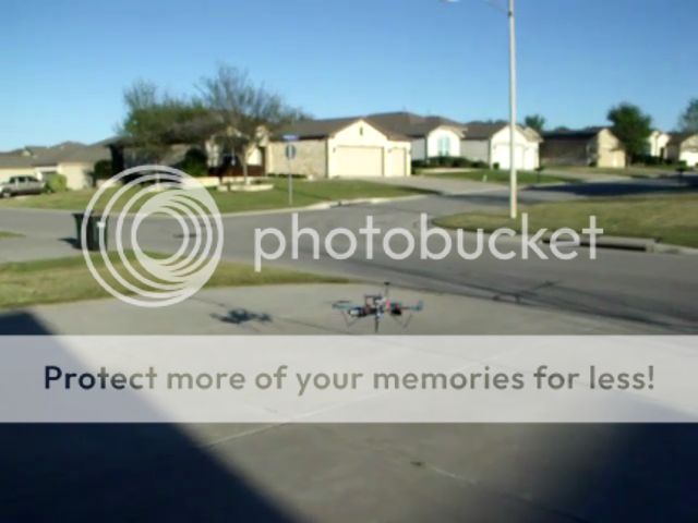

Time to take it out for a test flight!
vid296.photobucket.com/albums/mm185/GlassKnees/DSCF2289_zpsi5rg9ydk.mp4
Here is the video from the aircraft:
vid296.photobucket.com/albums/mm185/GlassKnees/Test%20Flight%20Onboard%20Video_zpsrsv5eqs3.mp4

Took it out for a test flight - appeared to be solid. Manually flew around - pitch, yaw, roll - all seems okay. But then the aircraft settled down in auto land mode, as if it reached power failsafe. I have the failsafe voltage set to 10.5, and I'm sure that it didn't reach that. the only way to tell for sure is to check the log file or fly it again with Mission Planner running so I can see what's going on.
