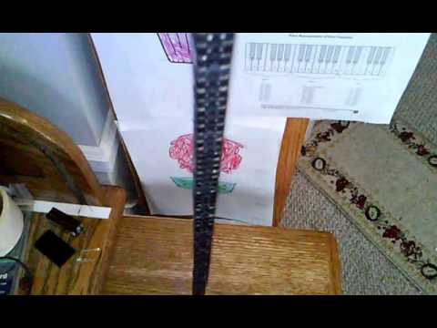

    Ditto. Machined pins are better and usually more expensive. Besides, wouldn't you prefer to buy On Shore vs. Assmann? :) (Manufacturers listed on Digikey website, moderators!)
    BTW, if you need any 8 pin sockets (or a quick method to test lots of any sockets), I got you covered.

    @Erco, that is a riot.
