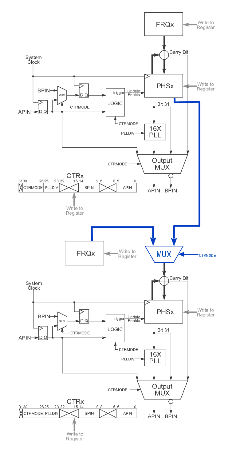

In searching for SETNIB as discussed in the other thread I found an old post of mine about Smart Pins and their potential use for decoding Delta-Sigma bit streams and jmg's and evanh's and another one additions.
Here evanh's schema for it.
104154&d=1380541194
Maybe now we have Smart Pin time ;-)

  • evanhevanh Posts: 17,163
    edited 2015-09-29 05:22
    All these things can be treated synchronously (Use the provided clock to stay phase aligned) or asynchronously (Ignore clock if it exists by oversampling > 2x).
  • MJBMJB Posts: 1,235
    edited 2015-09-29 09:32
    or just count in edge mode - gate time given by system counter + SW
    by using evanh's scheme where each counters output can be muxed to the next as input even higher order can be easily achieved.
    would only require one bit (or part of) in the counter config register
    - and of course some code ;-)
    maybe now it is time to remind Chip ...
    Delta-Sigma bit stream decoder for smart-pins
  • cgraceycgracey Posts: 14,297
    cgracey wrote: »
    MJB wrote: »
    But, we only have a first-order integrator. I think the only useful thing we can do is count highs over a period. We also have a counting mode that increments on this pin's high and decrements on the adjacent pin's high, for differential measurements.
    evanh's schema in the first post shows - given the Prop1 counters - how counters could easily be chained to create higher order integrators
    by just putting a MUX in there.
    So when each smart pin has one counter
    then just feeding it's output to the next pins input
    would do it - right?
    maybe this is possible already.
    Ideally of course without loosing the default IO functions of all but the first input pin. By just using their counters.
  • jmgjmg Posts: 15,200
    MJB wrote: »
    ... by just putting a MUX in there.
    Easy enough to type, but that 'just a MUX' is a 32 bit MUX plus 32bit data path between each pin cell adder.
    Chip is trying to lower the logic cost now, not increase it.
    edited 2016-01-03 23:44
    jmg wrote: »
    MJB wrote: »
    if there is a good reason not putting it in then this is fine with me.
    Just wanted to make sure it is not overlooked and accidentally forgotten.
    you jmg have been part of the discussion long ago ;-)
    edited 2016-01-04 00:54
    I think that to get generally-expected sigma-delta ADC performance, we'd need a special decimation filter, which is not trivial. Also, we need a second order analog integrator, which we don't have.
