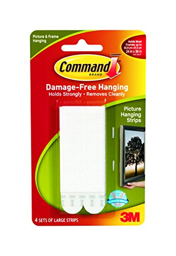

  • This must be the first time I have heard of anyone mounting PCB's with Velcro. Is this for some kind of wearable or what?
    I do this every so often on robots when I'm not sure where I want the PCB to end up. I often use this stuff for mounting if I'm not sure where I want the PCB to be.
