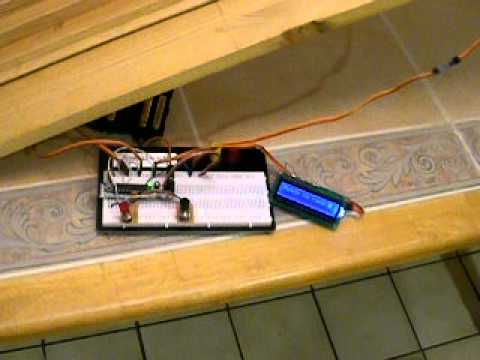

Hi everyone,
I was recently direct to this forum and these products by a coworker. We were talking about how to biuld a Pinewood Derby Sequence of Finish timer for an old track we have when he suggested this might help. I dug through what I could find and there are two old threads that are related to what I am doing:
http://forums.parallax.com/showthread.php/102321-Inferred-start-finish-line-detector-with-timer.-For-co2-cars!!!?highlight=pinewood+derby
http://forums.parallax.com/showthread.php/136035-Race-timer?highlight=pinewood+derby
Like user arend in the second post what I am looking to do is this:
Make a Sequence of Finish timer that uses:
-A control switch at the top of the track at the start gate to signal the beginning of the race (mechanical)
-Set IRLEDs and photo sensors at the finish line for either 6, or preferably 8 lanes. IRLEDs and the bottom and Photo sensors in tubes above them.
-Set up a simple 7 segment LED display (2-4" tall) that shows what order the cars finished in above each lane (6 or eight displays in total)
Mostly what I have been finding is timer circuits which could work in place of SOF, but I want to keep it simple. One idea I had previous to this was building 8 simple digital stopwatch circuits (one for each lane), and tying the start and reset functions together. The hard part was the finish line circuit that would stop the timer count as each car passed over a sensor. The designs I saw were simple in that the start/stop functions were one and the same which would work for me. This is why my coworker suggested the Propeller. I've seen similar ideas on Youtube for Arduino based systems but nothing to handle 8 lanes for cheap.
So, for the group, is this something the Propeller could do? I am more than capable mechanically, and electrically and have some programming knowledge. If I were to got his route what do you think I would need?
I know some things would be:
- 6 or 8 sets of IRLED/Phototransistors
- Start switch
- Reset switch
- Structure for the finish line sensors
- 6 or 8x seven segment LED displays
Any help would be great.
Len

    I built a pinewood derby timer four years ago.
    Here's a video of the prototype
    I posted a blog entry with the source code:
    http://forums.parallax.com/entry.php/3396-My-Pinewood-Derby-Prototype

    Yes, the design can be scaled up to six or eight lanes. We initially used overhead lights, but had occasionally failures to detect a car finishing. We found having a lamp directly over the finish line improved reliability considerably.
    Note that this design is really simple and could work with either an Arduino or Propeller chip as both of them have internal tick counters that can be used to time events. Only a little of the code interacts with the Arduino library and it would be easy to replace with native propeller C equivalents. Electrically it's two push button detection circuits, a three pin able for the servo, and a bunch of either CDS or photocells to detect the light transition.

    There's really only few kinds of circuits you need. If you learned how to do one a night you could probably have a prototype in a week. Soldering together the finished unit would take a few evenings at most, and that would include making the sensors and cables.
    The first circuit is one to detect push buttons to start and stop the race: http://learn.parallax.com/propeller-c-simple-circuits/check-pushbuttons
    The second is one to sense a change in light levels as the car passes overhead: http://learn.parallax.com/propeller-c-simple-circuits/sense-light
    The final circuit is connecting the microcontroller to a display device like an LCD panel. That's less of a circuit and more just connecting the output of six pins into the correct leads of an LCD panel. HEre's an example in Spin http://tymkrs.tumblr.com/post/87994050098/parallel-lcd-propeller-and-in-spin

    A single propeller chip would easily handle measuring the elapsed time for 8 lanes as well as determining the finish sequence and displaying it on the 8 led displays. While you can't display the elapsed times on a single digit display all of the information (Position, Lane, Elapsed time, etc.) could be sent to a pc/laptop or displayed on a tv or computer monitor using the same propeller.
    edited 2014-12-26 21:01
    I looked at prices for parts on mouser for what you would need to build the lane sensor boards while shopping for other parts. The total price per board for the semiconductors is less than $15.00 per board. Add $5.00 for a small pad per hole pcb (1.5” x 2.5” min) and the total cost per board is $20.00. Interesting thing is you need to order 10 rather than 8 of the semiconductors to get the better price so you end up with some spare parts.
    Add $20.00 for a propeller proto board and about $20.00 for a 9V 1A power supply and the total is about $200.00 not including any shipping costs. A little scrounging might even reduce that some.

    The physical layout of your setup needs to be taken into account for the overall design so the length and width of the lanes, placement of the controller, and start gate mechanism needs to be known for an optimal design. A diagram with measurements would be a great help.
    As a starting point I looked at the following parts:
    1 - Start gate switch: starts the timers when closed, resets system when open.
    1 – Propeller Project board: system controller.
    1 – 9VDC 1Amp power supply.
    10 – Led displays and drivers
    10 – IR receivers and leds
    10 – Voltage regulators
    8 – Pad per hole circuit boards
    FYI, Buying 10 pieces for some of the parts is less than buying 8.
    BTW, if you had an extra monitor you could use for this it would make for a less costly and more capable system.
    edited 2014-12-28 19:06
    I was able to build my Pinewood Derby timer for around $120. I used a high torque servo to lift and lower the gate and a cheap LCD to display the data.
    Here's a copy of my timer code for the Arduino. It should be easy to port to the prop either by replacing the Arduino library calls with their Propeller equivlents or using my own library: https://code.google.com/p/lib-propelleruino/ which reimplments many of them.

  • LFransenLFransen Posts: 9
    edited 2014-12-29 08:59
    Wow this is awesome. And a bit overwhelming. Martin, did you use an Arduino with this?
    So this first thing I need to do is decide the output mechanism (LED display or LCD)
    I also need to decide on time display or finish order.
    Aside from the programming logic of deciding finish order I think I have quite bit to start on.
    So the last thing I am wondering is if the Propeller has a sufficient number of I/O to handle this. I would need 6 or 8 for the lane sensors, Start gate, reset function, and output to drive the LED displays or LCD. Th other option is maybe the Arduino Leonardo. Seems to have a lot of I/O capabilities.
    edited 2014-12-29 12:38
    The propeller has more I/O then the Arduino so that won't be a problem. I wrote it for the Arduino four years ago, but most of the code should work on the propeller. I've been working on cross compilation between the Arduino and the Propeller. Here's a video of one of my projects from my library's unit tests:
    [video=youtube_share;iydnohrqCBQ]
