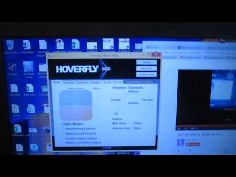

When I open hoverfly and connect my receiver and transmitter to the board, all my values are even....when I unplug the receiver and transmitter, the Aileron and Rudder on the hoverfly setup tool go all the way to the right...
Is there something I am missing?

    With the receiver and transmitter unplugged, there is no valid input for the setup tool to read. It's looking for pulses between 1 and 2 ms and getting nothing. That doesn't seem unusual on its own. Do the Aileron and Rudder channels respond correctly to the stick inputs. Left Aileron = left slider etc...
    Here's a clip I took of the setup tool a while back. You may see something there.
    Have you tried adding left aileron trim? Does it flip with no stick input?

    Yeah I spent 2 hours last night checking my controller and going through all the settings one by one according to the install guide. When I hook the hoverfly board to my computer, the settings are all in the center and do respond accordingly to the imputs I give.
    Now when the elev8 flips, im just giving it elevation aka go up and it still flops to the right.

    It flies! Omg it flies! So im definitely going to need some spare props until I get this thing under control but thats nothing. So I ordered a spare programming card and reprogrammed the e.s.c for each motor. That did the trick. Chucking this first card lol! Not sure what went wrong with the old one but whatever.
