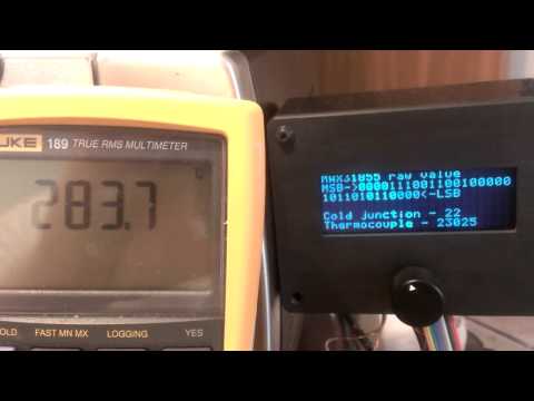

The temperature measurement is coming from 2 MAX31855 modules. The modules are designed and made by Maxim. The chip outputs a 14-bit temperature value, with each bit = .25°C (150°C = $0258) I drop the 2 right most bits, because I found the oven just works harder for nothing trying to maintain a .25°C temperature range.
But it does not matter now, I found out the MAX31855 chips are junk. At room temp (25°C) they read correctly, but the higher the temperature the larger the temperature difference. I have a Fluke DVM that can measure temperature. So I used it to check the temp of the oven. I had the oven set to 250°C, and the Fluke was saying the temp was 295°C. So I thought the Fluke was wrong. So I grabbed my $20 meat thermometer that has a separate probe and put it in the oven. The meat thermometer was about 5°C cooler than the Fluke. So that confirmed the 2 MAX31855 are not calculating the temperature correctly.
I am going to ditch the MAX31855's for this project. And make a proper thermocouple measuring setup.
I agree it is. I looked over everything and double checked everything. I could not find any problems. One thing I did notice, the cold junction of both chips are about 10℃ cooler then the area they are at. If I place my finger on the chip to warm it up, I can get a correct reading from the thermocouple.
I have no idea how to correct that since the chip handles the correction.

It is a IOtech DBK52. I was going to use what I found from this to create a thermocouple reader of my own. These things were not cheap, and company's wanted the best accuracy for testing. So I figured, why spend hours designing and testing my own, when an engineer almost 20 years ago did it for me.
You are not going to need the sign anyway, but this dos put it correctly in the long.
Can you post the binary for:
A complete response from the device (all 32 bits as returned in binary), plus show the Fluke temp in C. Room temp plus with the oven at some temp (ie 250C)

I modified Jon McPhalen's (JonnyMac) jm_MAX31855 object, so I could run it with 2 chips and in another COG.
Here is a video from a resting state up to 250°C. For the thermocouple value you have to add a decimal point after the first 2 numbers. I was just to lazy to add it. So 10125 is actually 101.25°C

My question as well, and just in case that is the problem, no reason to panic or buy new parts. As long as the readings are stable (off by the same amount) that can always corrected mathematically.
Yes I am. They came as a box set. When you buy the maxim max31855 development module, it comes with the thermocouple.
My question is, how can it be corrected?
I would double check the connections, programming, the chip, and thermocouple you received to be sure everything is as it should be. You can correct the readings to match the Fluke meter readings using the calculation below, but it is very strange to find that the correction requires a third order cubic spline to correct the reading. Makes me think your thermistor and chip are not a matched set.
TEMPERATURE = A + B*X + C*X*X + D*X*X*X
Where A = -4.5, B = 1.3, C = 0.0012, D = -0.000006 (-6 E-006) and X is the input from the MAX31855
That calculation should make the readings match very closely. The worst difference is 1% (2C) at 200 degrees C.
At work, we have different kinds of thermocouples, (probes, thick wire, thin wire, high speed, etc..) I will grab a few and test them out and see if they make any difference. At work we only use Omega K type thermocouples.
Thank you for the "third order cubic spline" I had no idea equations like that existed. Like I said, math is not one of my strong points. I am assuming the equation is the raw (14bit) value from the MAX31855. I will make a "DAT" table that will convert the temps.
