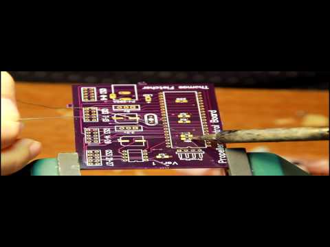

I have been learning how to make PCBs with diptrace and had sent off my first creation to OSH Park for manufacture.
They came back and so far so good. I haven't tested all the pins yet but Pin 0 is going out the first header and
I am able to program both the propeller and EEPROM. so yea!
I thought of a good name for the board AFTER sending the order in. Should of called it the Quick In&Out as that is
my "design philosophy" for it.
I wanted a controller that I could quickly change out between projects and I used DIP chips because I wanted
to be able to easily change them out also.

    I printed out the layout and glued it to foam core to test out the spacing of components.
    Glad I did as the 10 pin female headers were wider then the male headers. Something
    I caught by doing this.

    Video of me putting the first board together and testing it.

    The silkscreen above each connector reminds me what wire is what.
    Each 10 wire set has a ground, 5V, 3.3v as the left three wires and then 7 of the propeller
    pins as the next wires left to right.

    Cool. Was it hard to solder the propeller chip in? I am thinking about going surface mount to revisit my
    xbox controller remote control project.
  • FredBlaisFredBlais Posts: 381
    edited 2014-01-24 12:06
    Ragtop wrote: »
    It's not hard but it can take a bit of practice. If you can find a broken/old PCB with a TQFP chip on it, you could try unsoldering it, clean the chip and then soldering it again. You don't need a fine tip soldering iron but I suggest you buy some liquid rosin flux (http://www.electronicplus.com/images/products/10-4216.jpg) and unsoldering braid.
    you start by putting a bit of solder on let's say the top-left pad and bottom-right pad. After that you align the IC with all the pad and you secure it in place by soldering the 2 pads in diagonal. Then you can pour a bit of flux all around the chip and start soldering. When you solder that kind of package, try to avoid putting your iron directly on the pins, you only have to touch the pads with your iron, else you will end up with a lot of solder bridge and you will have to remove them with the braid and start over for the bridged pins. If you can find really thin soldering wire, it really helps because you only need a tiny amount of solder on each pad (once again to avoid solder bridges between pins).
    After everything is soldered, your PCB will be messy because of the flux, you need to clean it with isopropyl alcohol (rubbing alcohol).
    Hope it helps, and don't hesitate to ask any question!
