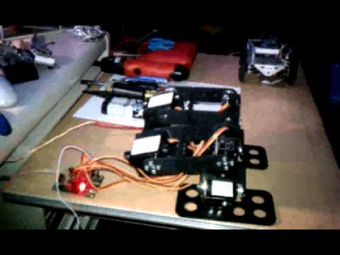

  • ajwardajward Posts: 1,130
    edited 2013-11-21 07:12
    This is =kind of= the final configuration for my intrepid biped buddy. I have more parts on order... some pan/tilt kits, servo horns and a gripper kit.
    Even having to disassemble the legs, I managed to install the aluminum servo horns with almost no harsh language. Okay... there was that one point when I realized I'd reassembled two left legs, but that's all... I promise! :-)
    Managed to get the servos to make a couple of basic moves, but nothing near actual walking. This project makes me appreciate the complexity of the human body =:-|
    First problem... the servos move =way= too fast. I've tried adjusting the 'ra' value in the PSC commands, but it doesn't seem to make any difference. Anyway... more work ahead.
    A short video of Wally standing up. Not difficult, just centering the servos on power-up. (Wish I had this much energy getting started in the morning!!!!)

    edited 2013-11-21 13:14
    Cool beans. Before you get too far in perfecting your walking routines, throw a bunch of simulated weight up top to represent your batteries and PCB. That weight will change your CG, balance, and pendulum timing for walking/swaying.
    Right you are!!! :-) For the moment though, I'm dealing with repeatability issues. That is, each time I energize the system I'm not exactly sure what the servos are going to do! I have the PSC centering the servos on power-up, then if I run a BS2 program to center the servos, they =might= not move OR they =might= move to some other position.
    Then, I have the servo ramping speed set to 32... a mid range value that should force the servos to move at a "kind of" slow speed. Not so much... Sometimes the servos move slowly and other times they =snap= into position like into my video clip.
