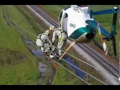

VIDEO - ..Electrical Workers Play With Power Lines — Parallax Forums

    And then there's the case where your good old bucket truck just won't reach.......
    edited 2013-05-30 12:24
    Did you notice the spark on the disconnect as the helicopter flew away?
    They used a probe to bring the helicopter up to the line voltage, then attached a cable while they climbed on and transferred gear.

    The first video, the sparks didn't quite seem real, the video may have been chopping them but the frequency didn't even sound quite right.
    The second video was much more convincing, but I'm not sure why they were working on this LIVE somewhere in the middle of the line.
    Loopy Byteloose, there was also a spark at the very beginning as the helicopter approached.
    I know two people (Lineman) that have lost arms and or legs because they became a human fuse. If the first video is is truly part of the training, then I pray for the families, but in the same breath. With something that serious, you don't cut-up and laugh about it. "Playing" with that kind of power is just asking for trouble - be careful what you ask for.
    edited 2013-05-30 13:30
    Loopy,
    That cannot be right. Unlike my playing with a Van de Graaff generators and such where you can stand on a plastic bucket and charge yourself up to the voltage on the dome, those lines are carrying AC. That means they are at a billion volts one millisecond an minus a billion volts 10ms later.
    So what voltage does that helicopter reach when it leaves?
    And perhaps there is the answer. If the line were DC and the copter was "up to the line voltage" then there would be no spark as it left. Charge will not want to move from place to place at the same voltage.
    BUT, as it is AC then as the copter moves away at some point it is charged to, say, plus a billion volts. But then the line is driven down to minus a billion volts. Tick, there is the spark.
    Note: In this post "billion" is whatever huge peak voltage that line reaches.

    The Helicopter by itself generates an electrostatic charge from the rotating blades that is DC ,,, that is what you are seeing, not the HV from the power line... (I think)
    edited 2013-05-30 13:58
    Beau,
    That does not sound right either to me.
    If a helicopter "generates an electrostatic charge from the rotating blades that is DC" then we would be used to seeing such a spark show everytime a helicopter landed. We do not.
  • Beau SchwabeBeau Schwabe Posts: 6,574
    edited 2013-05-30 14:05
    http://aerialmachineandtool.com/webshaper/store/viewProd.asp?pkProductItem=14
    http://en.wikipedia.org/wiki/Helicopter_support_team
    The job of the Static man is to use a grounding rod to attach to the hook so that the static electricity conducted by the helicopter is grounded out and does not end up killing a Marine.

    Heater, they most certainly do have a VERY significant charge. I worked in aeromedical healthcare for a long time and there were numerous times where the bird pulled an impressive arc just before landing. You definitely do not want to touch a helicopter in hover/no ground contact. I think the military guys use a grounding pole or something similar. I'm not exactly sure how they rappel onto a surface without getting the Smile knocked out of them. Anybody know?
    edited 2013-05-30 14:15
    Interesting. So how come all helicopters landing anywhere don't have a "static man"? I have watched the air ambulance landing outside our local hostipital many times, no sparks.
    Well, OK, normally when a copter lands there is nobody standing under it ready to get zapped. On the other hand we don't seem to see sparks as in the video jumping between copter and ground.
    Now I wish my old car had a "static man". I used to get zapped badly every time I stepped out of that thing when driving in dry weather:)

    incorrect . The sparks are Littrly charging the helo ...the reason there is not one zap but many is its AC ..
    the Helo is Lagging in its voltage just as a Cap does ! .....
    The stick is so that the helo can pardon the pun Float at the EHV and become One with the line .....
    I did the same with my tesla stunts ,,,,,, We can sit on a platform and Still get zapped by the fact that its AC near a some what conductive object our bodies .... this is why we use wire mesh suits and other trade secrets to keep us safe

    If it was DC there would be One spark ,....

    Its NOT static ! ...... take a blimp in place of a helo and the same can occur.
    you are gonna get AC phase Tweaked discharges . just as Heater described .... Its just Lag ! .
    ANY metal no matter how small has capacitance and for that matter at HV it does not need to be copper ..... mositure alone can behave as a Cap plate!
    Ask the people at LAPP ..
    and with HV you have a Voltage gradient that Like a greyscale goes from HV to GND ( some times phase to phase )
    If you have 1 MegV at one meter above GND you have set up a gradentst ,. and that is DC ....
    so If you were to have a Infintite ohm inpout meter and stuck it at 500 CM . you would get 500 kV ( with res;pect to GND)
    with AC the gradient is expanding and collapsing at 60 HZ
    Soooo at the same point with AC ... 1/120th of a sec the 500 kV point is positive and the next its negitive ...
    You have a object there that is not air ... Its gonna GAIN a charge just as a cap does .
    remember the world is the other plate .......
    Birds are 80% water line us ( a plate or a object ) . the same shock that charges that helo can give a zap to the bird .....
    those non contact voltage indicators use the same idea with a FET as a input ,,,,,,
    the voltage in your home makes a darn small gradients..... but at nasty 400kV the gradients is HUGE .......
    Ill head to the lab and show you at 15kV how I can draw a buzz to a metal isolated sphere this afternoon ..
    toss EE 101 out the door ., once you get in to HV the rules are not allwas the same
