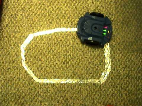

Chrome "Duck Tape" from WalMart makes a dandy line for robot line following.
    Yes it does - that's what we used for the line following competitions at Expo 2012 in our back parking lot - the tape is still there like we laid it yesterday.

    I thought you used aluminum foil tape... like http://www.amazon.com/gp/product/B000HBOYZO/ref=pd_lpo_k2_dp_sr_3/179-0767128-8112843?pf_rd_m=ATVPDKIKX0DER&pf_rd_s=lpo-top-stripe-1&pf_rd_r=07P63EF8V3XH7R2X42JB&pf_rd_t=201&pf_rd_p=486539851&pf_rd_i=B007A5ZIE6
    That might be be shinier & flatter, but the Duck tape is cloth-based and can be torn easily into strips. This cheapskate can get 3 strips out of the 2" wide roll. :)

    I layed the roll on its side and used a strip of 3/4" wood as a guide for my razor knife as I carefully turned the roll against the knife, that made for three nice shiny rolls of line following fun..
