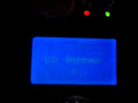

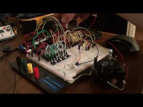

Testing functions:
5/31/11
Teaser (test program):
Worked hard over this holiday weekend to get it to this stage.
There is still a few small bugs I have to work out, but there is sign of life after all.
Now that's a robot controller.
