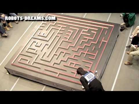

    edited 2012-06-04 10:23
    Roger Lee wrote: »
    Absolutely no way this can be done with a BS2.
    OK, OK. Beating this guy might call for a Propeller. He keeps going faster & faster (amazing 4.693 fastest time at 1:35 into the video) until he loses traction and wipes out in his last two runs. WOW.
  • Roger LeeRoger Lee Posts: 339
    edited 2012-06-05 13:42
    Those micromouses (micromice? that doesn't sound right either) are absolutely amazing.
    I'm sure we are talking hundreds of hours of testing, testing, and more testing.
    Heck, my battery pack has more mass than that whole machine.
    I've seen enough of your work to know you could do this. Any flavor of Basic Stamp OK my me.
    My last post was put out there not as doubt, but to give you a reason to do it. Go for it, man.
