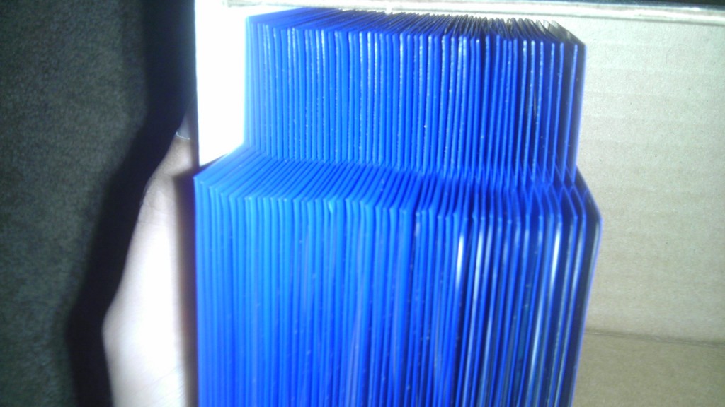

So, I want to build a machine to manage my collector playing cards. It will need to store all the cards in such a manner that it can keep track of which cards are where, and then retrieve a card from this storage. When all finished, I would like to be able to load a 'deck file' on the pc, then have the machine pull out all the cards to make this deck. Wear and tear on the cards needs to be minimal, and not mark the cards. I can't place each card in an individual holding place due to shear amount of cards and cost of space/money. I'm not against putting them all in card protectors (which is expensive in it's own right given the amount of cards I own...)
I'm still brainstorming on how random retrieval of the cards is going to work. My current top idea is to have all cards in card protectors. This better allows me to insert a thin metal tong type gripper into a stack of these cards with a low chance of damage. Now comes the hard part, knowing which card to pull out. I can keep the current order of the cards in a database, which tells me which card in the stack... however how can I count the cards to get to card 80 or whatever?
Currently I'm looking at storing the cards in a stack that is parallel to the ground. A small actuator will keep a certain amount of pressure on the side of the stack since it will grow and shrink when adding/removing cards. The cards will sit in a 'L' type channel with the corner pointing towards the ground. This will keep the cards from working their way out due to gravity, instead they will tend to settle into the 'L'.
The mechanism for inserting and removing cards will be a servo driven actuator with a couple of hobby servos to swing the gripper into the cards, clamp and remove.

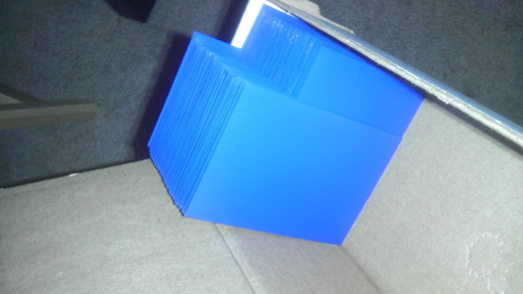

I've thought about placing every other card at 90 degrees. So one card will have it's bottom left corner in the 'L', the next will have it's bottom right, repeat. This gives me a small gap between every other card where I can better insert the gripper, and I may possibly be able to use this to count the cards as I go by. So kind of using the gap/card/gap as an encoder for the position of the actuator. I'm still now sure what I would use to actually count the gaps though... A small laser and light based prox that moves with the actuator shining inbetween each card maybe?
Does anyone have any ideas, clues, or any useful information you could share? I'm just throwing all this out there in hopes that a few more pairs of eyes and some seasoned brains may come up with something I haven't thought of.
Here are some photos showing the orientation of the cards and the gap I'm speaking of. Ofcourse there may be a much better way.
    edited 2012-01-08 12:15

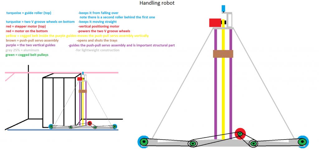

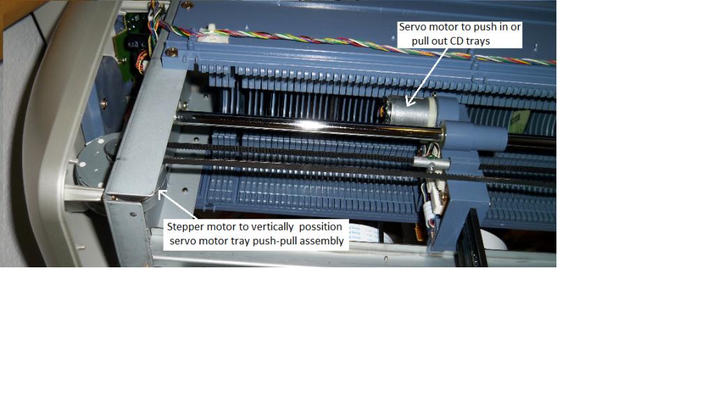

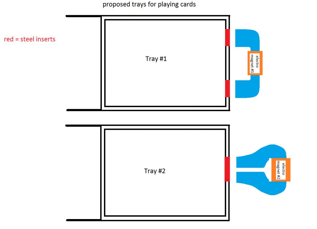

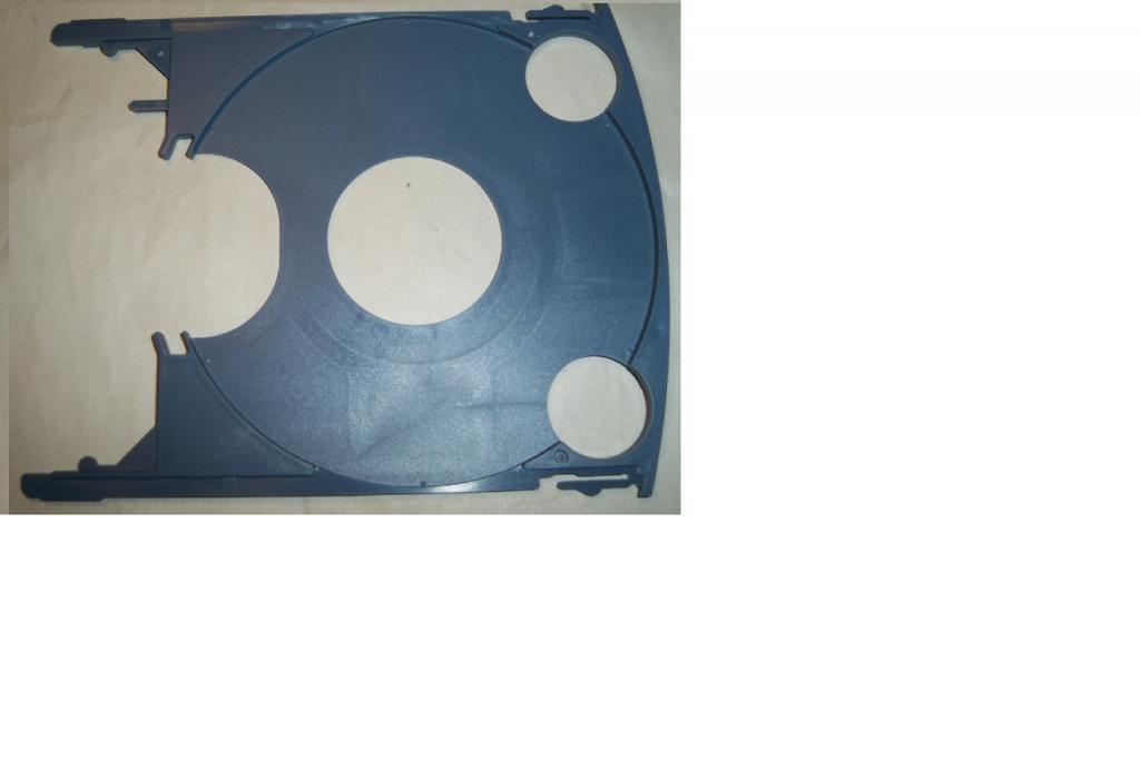

    I didn't realize how many cards you were talking about. I have an idea for a KDS CD organizer similar type system that could access thousands of trays and here's how that might work.
    In picture#4 you can see a drawing of what I call a Handling robot that is mobile because the robotics are in the front of the tray rack (in the KDS there in the back) which enables the robot to move horizontally to access multiple playing card tray racks in addition to increasing the length of the up and down travel.
    Picture#1 shows the back of the KDS CD organizer with the back cover removed, picture#2 shows a tray taken out of the KDS unit and picture#3 is a drawing of proposed trays for a playing cards type system.
    To pull the trays out from the front I determined it would be best to use electromagnets which also requires using two kinds of trays which also requires two kinds of electromagnets attached to a push-pull servo. The reason for two types of trays is so when an electromagnet is energized it wouldn't be pulling on adjacent trays because the trays types are alternated in the tray slots like for instance if tray slot#1 uses a tray type one, then tray slot#2 uses a tray type two and tray slot#3 uses a tray type one ect. Note as yet this idea remains untested.
    To go over the basics this Handling robot is planned to run on a single track using 90 degree angle iron usually cemented to a cement floor (the wheels have a 90 degree groove in them) that runs parallel probably to a wall that the playing card tray racks will be put against. Also since nothing is preventing it from falling over it needs a guide, a straight flat piece of metal that runs between the two guide rollers on the top and that is solidly affixed to the wall.
    The plastic parts might be expensive to get custom made, so I suggest getting a 3D printer to make the parts (most of the parts needed are just 3 different parts, the tray, and the left and right playing card tray racks halves) and when your sure of the design you could have them inexpensively bulk manufactured.
