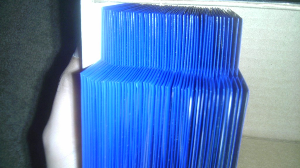

So, I want to build a machine to manage my collector playing cards. It will need to store all the cards in such a manner that it can keep track of which cards are where, and then retrieve a card from this storage. When all finished, I would like to be able to load a 'deck file' on the pc, then have the machine pull out all the cards to make this deck. Wear and tear on the cards needs to be minimal, and not mark the cards. I can't place each card in an individual holding place due to shear amount of cards and cost of space/money. I'm not against putting them all in card protectors (which is expensive in it's own right given the amount of cards I own...)
I'm still brainstorming on how random retrieval of the cards is going to work. My current top idea is to have all cards in card protectors. This better allows me to insert a thin metal tong type gripper into a stack of these cards with a low chance of damage. Now comes the hard part, knowing which card to pull out. I can keep the current order of the cards in a database, which tells me which card in the stack... however how can I count the cards to get to card 80 or whatever?

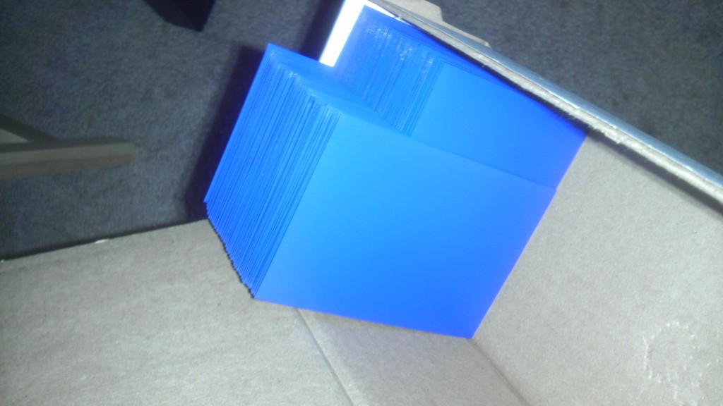

Currently I'm looking at storing the cards in a stack that is parallel to the ground. A small actuator will keep a certain amount of pressure on the side of the stack since it will grow and shrink when adding/removing cards. The cards will sit in a 'L' type channel with the corner pointing towards the ground. This will keep the cards from working their way out due to gravity, instead they will tend to settle into the 'L'.
The mechanism for inserting and removing cards will be a servo driven actuator with a couple of hobby servos to swing the gripper into the cards, clamp and remove.
I've thought about placing every other card at 90 degrees. So one card will have it's bottom left corner in the 'L', the next will have it's bottom right, repeat. This gives me a small gap between every other card where I can better insert the gripper, and I may possibly be able to use this to count the cards as I go by. So kind of using the gap/card/gap as an encoder for the position of the actuator. I'm still now sure what I would use to actually count the gaps though... A small laser and light based prox that moves with the actuator shining inbetween each card maybe?
Does anyone have any ideas, clues, or any useful information you could share? I'm just throwing all this out there in hopes that a few more pairs of eyes and some seasoned brains may come up with something I haven't thought of.
Here are some photos showing the orientation of the cards and the gap I'm speaking of. Ofcourse there may be a much better way.

    You could put tabs in 1 of 8 positions on the card protectors, spacers between each group of 8 cards, and a number of groups to a drawer , similar to the way phone number/address cards were used. A gantry could then select a group of cards and a gripper selects one of 8 tabs to pull the card from the drawer.

    kwinn> That would indeed work, however it would require adding the tabs. These are playing cards and that would mark them.
    AJ-9000> I have about 15000 of these cards currently.
    Spiral_72> Thanks! I hope I build it too :p Yes, one long row would be easier... however it would be like 20 foot long or longer.
    Thanks for the feedback, still working on it. Haven't thought of a better system just yet, so I may try to build a small prototype here soon.

    bill190> Space and cost go up quite a bit if every card is separated by some divider that isn't trivial (like maybe a very thin sheet of plastic). Really the robotic parts of the system are trivial. It's the parts directly dealing with the cards themselves that gets complicated.
    kwinn> Yes, tabs on the protectors themselves makes them unusable in actual play. Separators between each card would work. The only problem is what are the separators attached to? What is the cost per separator? Remember 10s of thousands of cards really makes things expensive if quick. Just premade card protectors in bulk can still cost 2 cents per one, 15000*2 cents is 300 bucks. That is possibly an acceptable cost since the protectors can stay on during play and prevent wear/tear.
