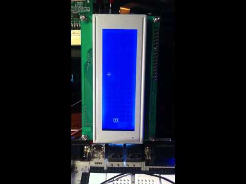

I just posted this over at Savage Circuits, sorry of cross posting bother some you. I thought I'd share it here too. I 've playing with that Matrix Orbital display some more. This morning I was tinkering and my 6 year old asked me you the joystick (that was still on the breadboard from something else) didn't make the text on the LCD move. So instead of trying to explain I thought I'd "fix" it.
At first I got it reading the U/D and L/R on the joystick using RCTIME and then coded a small loop to move a character around on the LCD. That gave me the idea of a game so it evolved into this:
[video=youtube_share;O2-OOD-9OfY]
The speed increases as you (represented by the * ) pass the top of the screen. If the opponent ( B facing down ) collides with the you it pushes you back until you move. If you get pushed all the way to the bottom the speed resets.
Here's the code:
{LCD_Game.spin
Paul A. Willoughby, DVM
1/22/2012
CON
        _clkmode = xtal1 + pll16x
        _xinfreq = 5_000_000             '80MHz
        _rxPin = 8         'using serial com
        _txPin = 9
VAR
       long ud, lr
       byte player_row, player_col
       byte opponent_row
       byte opponent_col
       byte delay
OBJ
  LCD         : "FullDuplexSerial"
  rc1         : "RCTime"
  rc2         : "RCTime"
  RandGen     : "RealRandom"
PUB Main
   Init
   repeat
      opponent_row := ((RandGen.random >> 1) // 4) + 1
      repeat  opponent_col from 1 to 19
          if opponent_col == (player_col-1) and opponent_row == player_row
             player_col++
          elseif opponent_col == player_col and opponent_row == player_row
             player_col++
          else
              GetPlayerCol
          GetPlayerRow
          MoveTo(opponent_col, opponent_row)
          LCD.STR(string("-B"))
          MoveTo(player_col, player_row)
          LCD.STR(string("*"))
          waitcnt(clkfreq / delay + cnt)
          Clear
          if opponent_col == 1 and player_col == 20
             delay := 5
          if player_col ==1
             delay++
PUB GetPlayerCol
    if ud >120
      player_col--
    if ud <40
      player_col++
    if player_col >20
      player_col := 20
    if player_col < 1
      player_col := 19
PUB GetPlayerRow
    if lr > 120
      player_row--
    if lr < 40
      player_row++
    if player_row >4
      player_row := 4
    if player_row < 1
      player_row := 1
PUB MoveTo (x, y)
      LCD.tx($fe)
      LCD.tx($47)
      LCD.tx(x)
      LCD.tx(y)
PUB Clear
      LCD.tx($fe)
      LCD.tx($58)    'clear screen
Pub  Init
      LCD.start(_rxPin, _txPin, 0, 19_200)
      RandGen.start
      waitcnt(clkfreq /2 + cnt)
      Clear
      rc1.start(4, 1, @lr)
      rc2.start(2, 1, @ud)
      player_row := 4
      player_col := 20
      delay := 5
Paul
