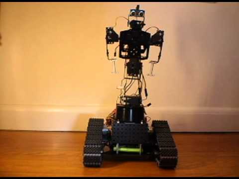

ZappBot 3 - Tracked Humanoid Torso Robot
The robot is 11" Wide, 12" Deep and 21" Tall.
It is controlled by a Propeller Chip P8X32A-D40 and a Digi XBee 1 mW Radio Module.
It's November 29, 2011 and I have been collecting parts for this Robot for about a year and started the build about November 1, 2011.
Pictures, Description, Part List and Block Diagram are shown in the slides below:
I can type commands on my PC keyboard to remote control the robot via a radio link.
The robot is programmed in Spin code.
At the present time I can send the following commands to the robot:
  • Move the Entire Robot
    • Forward, Backward, Rotate Clockwise, Rotate Counter-clockwise, Stop
  • Rotate the Torso
    • Left, Right, Center
  • Control the Head Movement
    • Pan Left, Pan Right, Pan Center
    • Tilt Up, Tilt Down, Tilt Level
  • Control the Left Arm
    • Left Shoulder Axis 1
      • Swing Up, Swing Down, Swing Forward
    • Left Shoulder Axis 2
      • Swing Up, Swing Down, Swing Out
  • Control the Right Arm
    • Right Shoulder Axis 1
    • Right Shoulder Axis 2
  • LCD Back light
    • Turn On, Turn Off
