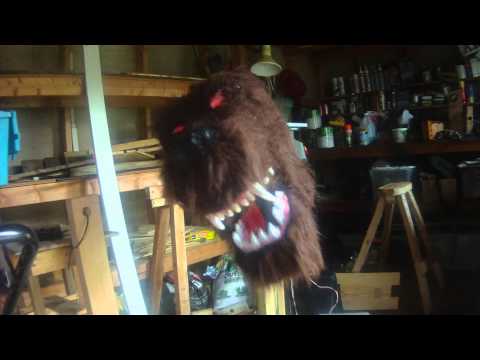

This year I am going with "simpler" shock and awe. A man eating dog popper controlled by a propeller chip.
It will use a laser/photoresister tripline to start the routine which is:
1) LED eyes come on
2) 12v motor turns pushing head out
3) MP3 trigger board starts audio barking file
4) Canon Digital takes photo
5) Jaw and head tilt servos activate
6) 12v motor turns pulling head back in.
7) LED eyes go off as it waits for next victim.

I purchased this 12V amp off ebay and I HIGHLY DON'T recommend it. I wasn't expecting a lot out of the amp, but was hoping it might be a way to run the whole system off the 12v battery without having to run off a generator. Location is a field.....
The amp didn't really do much and the usb port that I was hoping to run the mircocontroller off of quit working within days.

The head is a two-part plastic resin that I got off Ebay. Cures fast and really hard.
I ended up having to use waitcnt(clkfreq/1500 + cnt) so routine length was same as audio file.
routine := 0 repeat while routine < 5568 'servo mouth and head action routine++ waitcnt(clkfreq/1500 + cnt) 'divided sound file into hundreds of a second to sync case routine 2: outa[barking] := 0 279: mouthposition:= open 537: mouthposition:= closed TakePicture 558: mouthposition:= halfway 788: mouthposition:= closed 1006: headposition := 190 'tilt head 1119: mouthposition:= open 1358: mouthposition:= closed 1430: mouthposition:= open 1628: mouthposition:= closed 1657: mouthposition:= halfway 1891: mouthposition:= closed 2004: mouthposition:= halfway 2336: mouthposition:= open 2489: mouthposition:= closed 2614: mouthposition:= open 2921: mouthposition:= closed headposition := 90 'tilt head 3293: mouthposition:= open 3439: mouthposition:= closed 3576: mouthposition:= halfway 3782: mouthposition:= closed 3972: mouthposition:= halfway 4913: mouthposition:= open 5103: mouthposition:= closed 5212: mouthposition:= open 5439: mouthposition:= closed mouthposition := halfwayNice project, BTW. How much more work do you estimate needs to be done until completion?
It is pretty close. I have a problem with a servo linkage arm that keeps popping off. It is suppose to tilt the head side to side. And I have to figure out why I am getting so much feedback from a dual amp set-up.
It is going to have a frame in front of it holding up a red paint stained plastic sheet that the head will pop out through.

They have boards that take care of the sync issue and you don't need a microcontroller to handle the servo commands. These boards are call Audio Servo Controllers and you can get them form http://www.audioservocontroller.com . This website was started by a EFX-TEK forum member Jackman, where I post all the time under the same user name.
All the microcontroller needs to do is start the MP3 player. When, the sound starts to play the Audio Servo Controller starts to moving the servo in sync with the sound.

The first picture is hilarious!! It looks like she nearly jumped out her skin.. HAHA!
To go with a body, I am going to have to switch to pneumatics.
As far as storage, I am still working on that. The head was originally removable. but I was afraid of it working loose so I went crazy with the gorilla glue.
