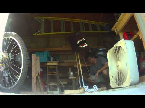

Last year I created a Killzone for Wayne's World of Paintball's Haunted trail that they do to raise money for Toys for Tots.
This year I am going with "simpler" shock and awe. A man eating dog popper controlled by a propeller chip.
It will use a laser/photoresister tripline to start the routine which is:
1) LED eyes come on
2) 12v motor turns pushing head out
3) MP3 trigger board starts audio barking file
4) Canon Digital takes photo
5) Jaw and head tilt servos activate
6) 12v motor turns pulling head back in.
7) LED eyes go off as it waits for next victim.

    I modeled the head using paper-mache. I then tried to make a mold using silicon chalking but it didn't really work. Got the head out of the mold but had to destroy the mold in the process. I eventually bit the bullet and bought the real mold making material which I used for the lower jaw and teeth. The teeth were modeled using artist clay.
    The head is a two-part plastic resin that I got off Ebay. Cures fast and really hard.

    I am working on syncing the jaw movements to the audio file. I have an audio editor that lets me look at the wave form in 1,000s of a second. So I was hoping to use a repeat while loop with 1/1000 second waitcnt and a case statement that would change servo position according to the count.
    I ended up having to use waitcnt(clkfreq/1500 + cnt) so routine length was same as audio file.

    A way to move the mouth in time with the sounds that would be less painstaking to routine (and more accurate) would be to use an external ADC (or the RCTIME thing like the BS2 has, as the prop has no ADC) and measure the amplitude of the sound. That can adjust a variable which opens the mouth wider with a larger amplitude. I did something like this a few months ago for a project, it was a talking head (made of legos!) and it took voice input from the user. It worked pretty well. Plus, if you decide to change the sounds, there is really no extra work involved, as your circuit does it for you. Sorry I don't have documentation on it... it was in 8th grade and I didn't really think to do that though:(

    It is pretty close. I have a problem with a servo linkage arm that keeps popping off. It is suppose to tilt the head side to side. And I have to figure out why I am getting so much feedback from a dual amp set-up.
    It is going to have a frame in front of it holding up a red paint stained plastic sheet that the head will pop out through.

    The 12v motor was at it's limits with just the head. I actually had to change my plans because it was not reliably pushing the head out. It pulled back with lots of force, so instead of resting the head in the back position, I left it sticking out at rest. It was in a shadow so it couldn't be seen without the spotlight on it. Then I cycled it in and out while barking which actually looked better then my original idea of just popping out, barking, and then pulling back in.
    To go with a body, I am going to have to switch to pneumatics.
