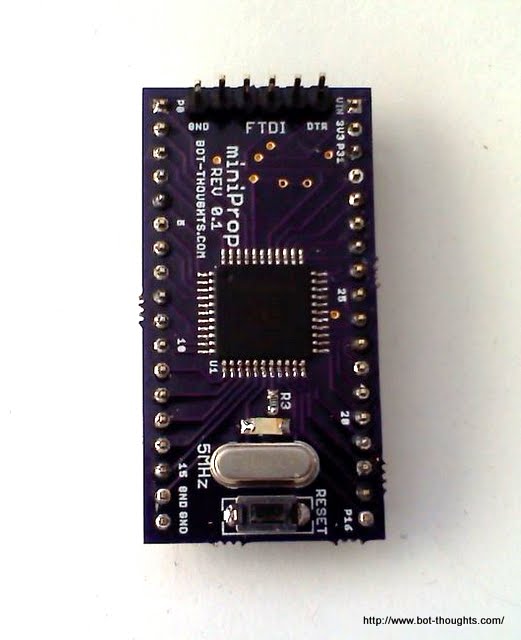

Propeller, EEPROM, 3.3V regulator, 5MHz crystal, reset button, green power indicator, and 6-pin Sparkfun 5V FTDI breakout header in a single DIP package. I wanted a cheap, easy way to breadboard a Propeller for various projects.
I got three boards, and I'm giving one away on the Bot Thoughts facebook page, leaving me two, plenty to keep me busy for awhile.
Hmmm... maybe I can get back to troubleshooting that Game Boy camera driver. :D
PS: oh sure, _now_ I find out someone else used the name MiniProp. Smile. Oh well, Rev 0.2 will be called the btProp I guess.

    Any EEPROM? Another question, what CAD program did you use? Will a schematic be posted anytime? Looks like a fairly easy layout/routing job, Now for a bottom view too!?
    Thanks for the 'show-n-tell'.
  • shimniokshimniok Posts: 177
    edited 2011-10-10 06:43
    EEPROM: yes; it's on the bottom along with the regulator. I'll post schematics per OSHW when I get Rev0.2 done. I'll post some better pics when I get a chance, top and bottom both. I used Eagle CAD. Layout was pretty easy in 2-layer.

    I see the decoupling caps a bit on the fewer and far side... Some extra caps below the Prop's package can be easily fit, don't you think ?. Nice module!! BTW, the color is just awesome !
    edited 2011-10-11 03:06
    Nice pcb. I recognise the purple pcbs.
    However, as Ale said, you need more decoupling caps.
    I agree, several 0.1u or 0.22u ceramic decouplers directly under the prop is a wise precaution and a ground plane is wise too (or is it 4 layer (!))

    Thanks all, great feedback! I'll stick some more decoupling caps on the power pins, then.
    Question--- do you think a ground plane that is interrupted by the regulator & EEPROM would be adequate? Or should I move those up top with ground plane underneath?
    Attached is the schematic & board layout. Any further feedback is much appreciated!
