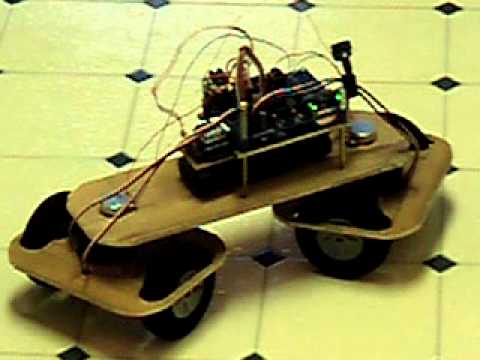

I had held off building for a while. As I was not sure it would work at all,
Glad I finally started this build, This thing is a kick to drive around.
The 10K pots on each end only allow for about 250 degrees of steering, but thats ok, It would have been
extra expense because of the special wire management issues involved with 360 degrees of steering rotation...
The exact length of pipe and the pot shaft was dictated by tire clearance under the frame.
The "axle" is 1 1/2" ABS pipe, cut to the same length as the protruding shaft.
Here is an action shot of the pot being tapped with a 4/40 tap...
Notice the custom fabricated high speed motor mounts underneath.(the holes reduce wind resistance)
I would not want to stall all four servos at once, It makes the voltage regulator a little warm to the touch..
I do have hopes and dreams of making the 10K pots and the Memsic 2125 actually do something...
Right now, it takes two thumbs on the N64 joystick C and D pads to operate the thing, (takes a little practice..)
It could use alot more horse power, and a wiring harness, but it sure is fun to putt around with.

    That's got to be the wildest, most demented-genius (meant it in a positive way! :) ) steering arrangement I've ever seen! Congrats for making it work!

    Now THAT'S what I call some robot building! Way to get creative, looking forward to seeing some video of that baby's potential sidewinding motion!

    Wow,looks great.Is this an original idea?Its surely the first Ive seen a steering/driving configuration like this.Nice Job

    This is a very interesting project. With the PPPB, it could use a Propeller algorithm to drive itself and coordinate the wheel platforms for interesting and useful motions. It looks like they could traverse up and over the perimeter of rocks and planetary mounds. Do you have Mars in mind?

    Just needs a little help from the Memsic 2125, I know it will balance itself...
    I want to cut it in half and add a ball joint and another pot, but that is far in the future.

    LOL! That was enough of a clue to guess at the ending. Mounting the wheels forward of the pivot and adding a caster behind it would solve that problem, BTW.

    It actually is very stable if I'm not trying to do stunt maneuvers.
    This might be the video that erco has been waiting for...
    [video]
    Short but sweet. :thumb:
    I want to articulate the mid span so it will twist and hopefully keep the tires in contact with the ground.
    It really doesn't have enough horsepower for rock climbing, so I have not put it to any climbing tests.. yet..
    Really just wanted to see if it was worth pursuing, I think it will be worth a second look...

    What if each wheel assembly was a self contained unit with a Prop, Battery and motors. Then you could go 360 without wiring issues. you could use an IR link to communicate betwen the two wheel assemblies and the main control unit on top.
    edited 2011-09-29 09:30
    This drive sort of reminds me of a two wheel synchro drive. But rather than have gearing turn the wheels, they are in differential pairs so they can turn themselves.
