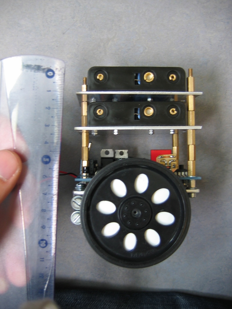

I am a student electronics, and i am fascinated by robots. This is the third robot i have build in my life. I live in Belgium(the country with still no government).
I sow somewhere on the net a home made robot that could stand stil on 2 wheels, somting like a segway. So i got the idea for a new project to make.

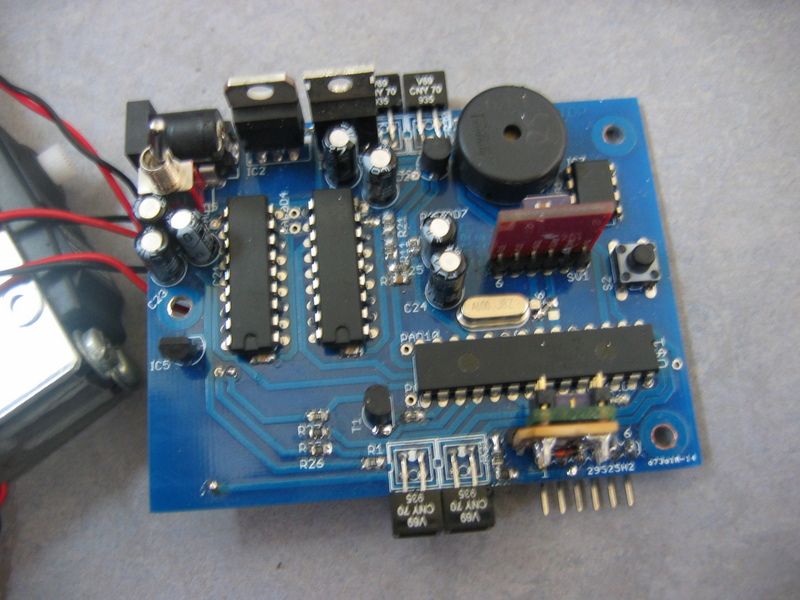

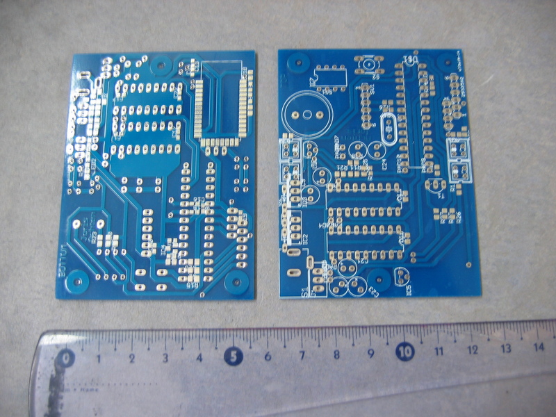

I started the design in september, between my studies i found a little spare time to build and program the robot. I add a lot of futures and flexibility in the electronic design. After a lot of designing and fitting i finished with an 2 layer PCB of 6 cm by 8 cm. (thats 2.4 by 3.1 inch for the Amerikan people)
Hardware present on this PCB:

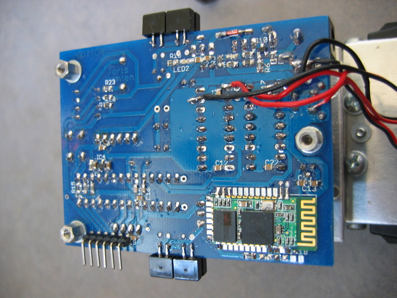

- 1 bluetooth communicator
- 1 Gyroscope
- 1 acceleration sensor

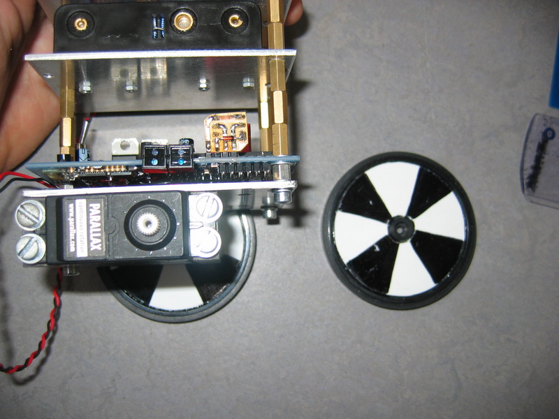

- 2 wheel decoders
- 2 motor servo's with coninue rotation
- 1 18F2520
- 1 battey charger
- 1 piezo speaker
- 1 indication LED
- I²C connection for expandable modules (not yet implanted on the PIC, but bussy with it)
- Program connection for PIC (never used, always programmed with a boot-loader and bluetooth connection)

Project fotos:

nice project and yes please post your progress
Also I note the RF-module (bluetooth I presume) on the board, it seems to match the Seeedstudio's BT module in appearance - is it currently used and if so does it perform well?
