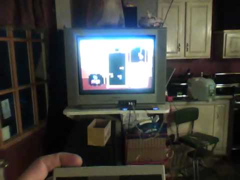

Hey folks, just finished my communication-hub-uber-transmitter (of Death). Man, am I happy with what I was able to stuff into this guy...

(this top one (at the end) shows the awesome video-game capabilities of the prop)

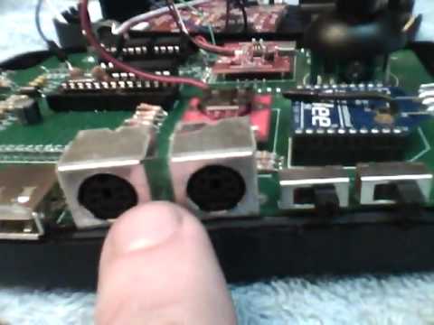

...and the insides...

On the power supply side of this project is the Li po battery used directly, or have you used some sort of buck-boost?
The lipo is a single cell (what is that? 2.7v 3.2v? 3.7v? somewhere around there) and goes to this guy. You get your boost to 3.3v or 5v (solder-bridge selectable) and built in "USB" (5v 500mA) charging. Not bad for $20. The battery is so small and with the boost, it eliminates the need for a ton of AA's to bring you above the level of a "regular" volt reg. Obviously, you loose some current-sucking ability during the boost but without motors --no problem.
Oh well, I have fortunately got enough lipo cells to go for the 8.4V - 5v - 3.3v route but it would take 80% of the volume that your remote takes. I did have a bunch of phone batts in a keyboard but they eventually failed and so the DracBlade in a Compaq KBD became less self contained.
