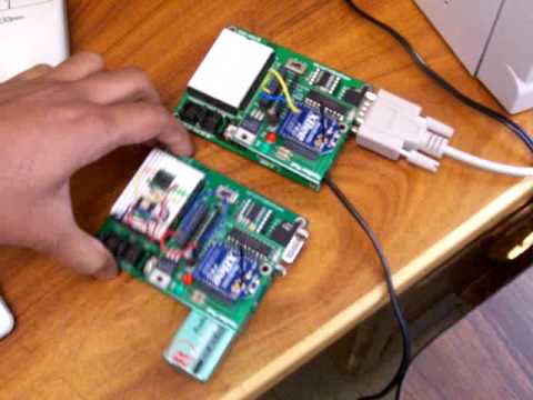

As others said, XBee would be a good one for RF communication. I did a project an year ago to read data from GPS, Compass and 2-axis accelerometer using BS2 and transmit data wirelessly to a laptop.
Check this link out...
I used appmods from selmaware to mount the xbee on the BS2.
satish

SURE you were part of it. I still remember when I could not figure out where I was going wrong with the XBee development boards from MaxStream. Using these appmods was pretty straight forward and there were sample codes available. All I did was change the code as per my requirement. Thanks a lot.
