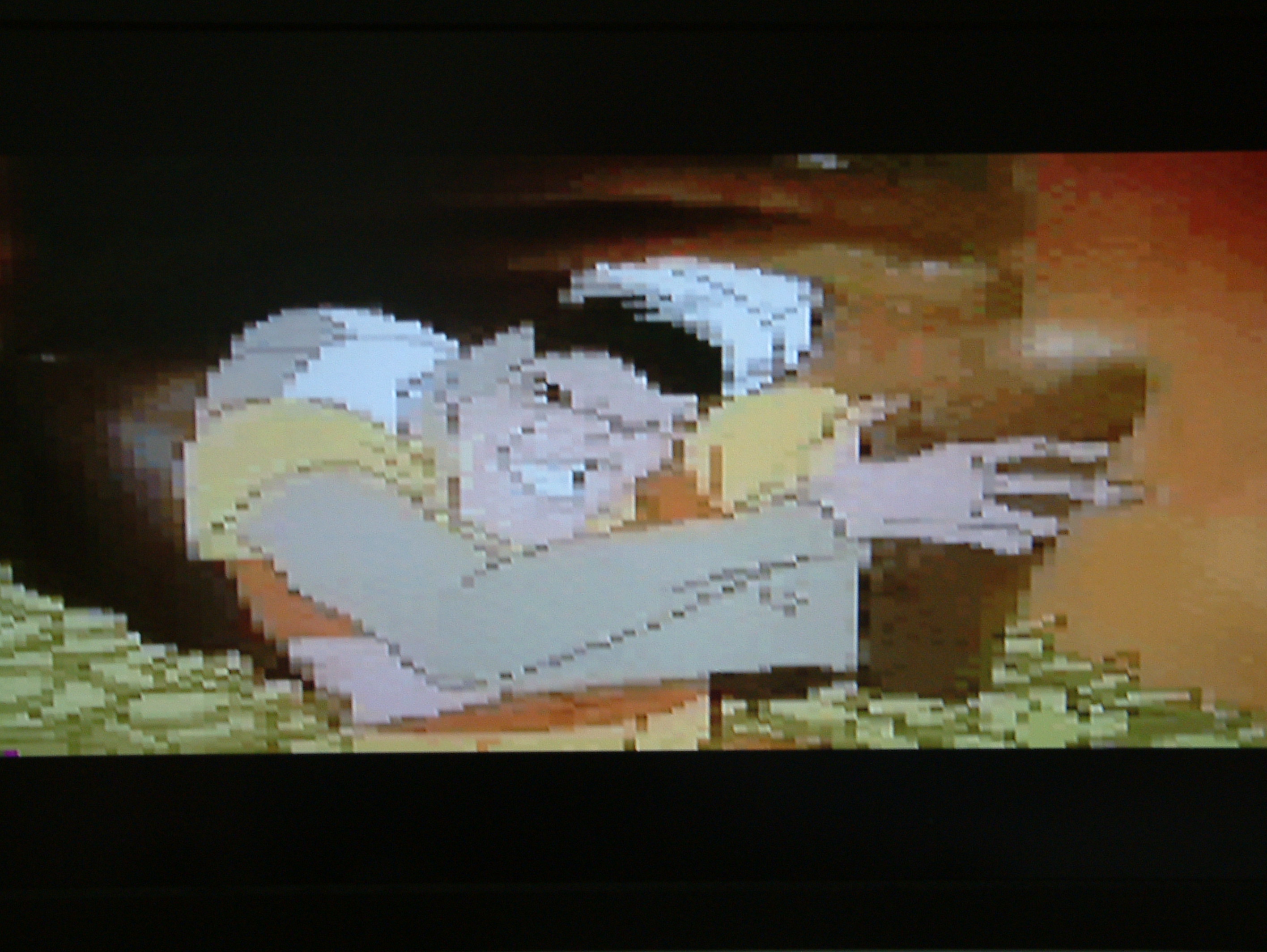

    NEXT UBER vid, ( sorry it's a 3gp from my phone cam, but the batteries went flat during taking the next vid, lol, will re-charge em and do new vid, but for now, here's a 3gp version. )
    I have the original on dvd, and was wanting to see how it would convert, so I got this intro vid off the net, to convert that, with it being smaller, and well, the results show how impressive it really is.
    http://www.jimbagley.co.uk/dlair.3gp
    edit:
    I've now re-charged my batteries roll.gif· Images below [noparse]:)[/noparse] and new vid link
    http://www.jimbagley.co.uk/dlair.avi

    Jim, Thats just fantastic! Any chance of getting some schematics or code? huh huh? <GRIN>
    I'd love to duplicate this..

    Oldbitcollector [noparse]:)[/noparse] are you UK based? as it's using a scart connector for the moment.
    Although I'll convert it to use an AD723/4/5 for US side, as it's gonna be an add on board for the hybrid. [noparse]:)[/noparse]

    Hi Baggers,
    Are you playing back avi files through the prop?
    If so, it is quite impressive.

    Baggers that's the most incredible thing I've ever seen.
    How much different is SCART from VGA?

    Hinv: It's originally an AVI, but I've converted it to be speed and prop and SD friendly.
    Forest: Thanks [noparse]:)[/noparse]
    rjo_: rofl
    Oldbitcollector: yeah, I'll prolly release specs once hybrid and the addon is out.
    Dennis Ferron: Thanks matey [noparse]:)[/noparse] SCART is TV timing, ( 64us PAL 62.5us NTSC ( or whatever NTSC is, not really done much NTSC ) and VGA is a lot faster.

    Hi Jim,
    What format did you convert them to?
    I played with high resolution playback on a 3840x1024 screen 8 years ago. I had 8 195MHz Mips R10000 64bit processors, 1GB Memory and 8 hard drives to play with.
    Yours, though quit a bit smaller is quite impressive as your resources are way less. I guess that is the power of getting right down to the hardware level.

    BTX: Thx [noparse]:)[/noparse] no worries about not seeing it, this forum changes like the wind. [noparse]:)[/noparse] and lol yeah, and I use a slightly smaller chip count than you rofl. PS, if you need a hand with the asm for your sampler, let me know.
    hinv: Hi Doug, I converted them down to a simple form, knowing that I only have a small amount of ram, I have to limit resolution to what fits, also, knowing that it HAD to be double buffered to avoid tearing, because I can only read about 6K per 50hz frame, and each image is 12K. Which works perfect since it takes two 25hz to read a frame [noparse]:)[/noparse]. It's converted into a 256colour per frame not constant colours though, they change each image. it was then a case of exporting each frame to a BMP, then resizing the BMP's to 120x90x8bit keeping the 4:3 aspect ratio, then merging them all into one 12MB file, stripping bmp headers etc. I originally thought about using compression on it, but then I thought, NO, I want lossless, because of the low resolution. And the finished result, looks really good [noparse]:)[/noparse] I'm well pleased with it.

    Hi Baggers,
    I would suggest lossles Run length encoding. This should work real well with cartoons like dlair. You could theoretically use 2 of the cogs to do the rle decoding on the fly. This would lower your bandwidth requirements on the input, and therefor may be able to buy you more resolution on the output and still do the same frame rate.
    http://en.wikipedia.org/wiki/Run_length_encoding in case you aren't formilliar with it.

    Bob the Builder on a C64: using SRAM for a higher resolution isn't really feasible, as it'd have to be an external device, to handle getting the data out fast enough for the display, then there's the problem of filling it too, during inactive display time, which is the problem with the X512K card for the hydra, this will be less of an issue when the prop2 comes along, especially with the extra 32 pins.
    as for more than one pin out of one pin, you mean like the joypads only using 4021's? yes you can do that. ps, I have 8 pins spare.
    hinv: I thought of RLE, but the images for DLair isn't really flat enough, and has lots of colours, and especially with the already lowered resolution antialiasing the image, it wouldn't really have made that much of a saving. but if you recall my other vid, the oxygene demo, which had a resolution of 240x160 which would have needed a screen buffer of 38400 bytes, was also double buffered, which would have needed 76800 bytes, which is far above the prop's ram size, that one was RLE, and the video driver uncompressed it on the fly, it only took one cog to handle the display and decoding. [noparse]:)[/noparse]
