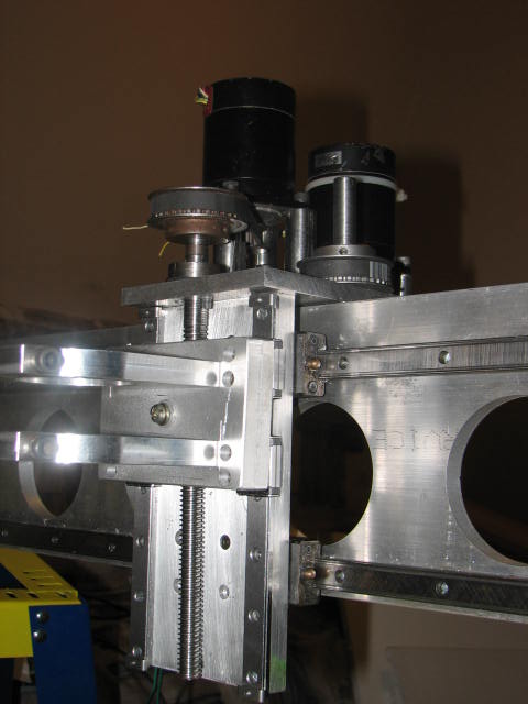

Hi there guys,· This is my latest project.· A Router/Laser CNC Table, I will include a BS2 Controller to communicate between the driver and the hand held controller. this is a 3 weeks project so far, and I am loving every minute of it.
Now I am not a Mathematician as I pointed many times, so I need help here.
I Move the Z axis 1" exactly (measured by a caliper)
the program read that it has moved o.621"
and the steps required to get there is 76,000 steps in 1/8 step
if I use full step,· the Z axis moves 1.247", the program displays 1.007368 with 7,600 steps
problem...·· and Question.
how many steps do I have to enter so the actual travel and the program read the same amount, either in full or 1/8 th step?
(reply with a simple answer, following by any formula you may want to provide.)

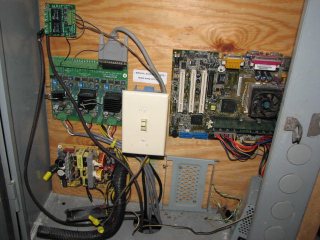

I haven't purchased the power supply yet, but I am using this 12 Volt, 1 amp power supply
it actually delivering 15.3 volts.· The Drive card takes 12 volt minimum to 24 volts.· at 6 amps max. (PWM)
·http://forums.parallax.com/showthread.php?p=641371·= $10 Stepper motor Controller
·http://forums.parallax.com/showthread.php?p=641605·= Serial to paraller expander
·http://forums.parallax.com/showthread.php?p=637017·= Robotic arm
now...· the transformer is getting warm, and I expect so, not been a real CNC stepper motor, driver power supply and all....· But why are the stepper motors getting Warm too?·· they are rated 5.5 volts 1.5 amp.·· the driver is set to deliver 2.5 volts in bi-polar mode· X2 = 5 Volts· and the amps can't be more than 1 because of the type of power supply it is..··· I am puzzled.·· help....·· please.

  • Skywalker49Skywalker49 Posts: 172
    edited 2007-06-15 18:57
    Willy,
    just to get the numbers right
    Real movement Program read out Steps(1/8) Steps(full)
    1" 0.621" 76000 9500 (=76000 / 8)
    1.247" 1.007368" 60800(=7600*8) 7600
    Q1: do I have the numbers right?
    Q2: what defines the program read-out? Shouldn't there be a straight relation between steps and read-out ?
    regards, Ed

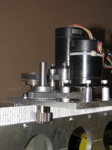

  • SawmillerSawmiller Posts: 276
    edited 2007-06-17 12:00
    i built a cnc machine so maybe i can answer your questions
    first of all stepper motors can get hot, as long as you can still put your hand on them , they arent too hot
    they can be overdrivin with voltage with no harm, just limit your current to the max your motor calls for
    i'm currently running 29 volts on 6 volt motors ( faster response)
    as for math just know your steps / rev of your motor and multiply it by your threads per inch (TPI)
    for example if you hook up a 200 step/rev ( 1.8 deg ) motor to a 1/4-20 allthread ( 20 tpi) just multiply
    200 * 20· = 4000 steps / inch in fullstep, 8000 in halfstep, etc

  • willy1067willy1067 Posts: 107
    edited 2007-06-18 04:03
    Dan, I will buy a better power supply on Monday (Radio Shack 12V 4Amp $48.00) to make sure I am not loosing steps as you suggested.
    About your calculation of steps and threads... there is another calculation to be added, as you can see in the X axis picture, both Z and X are using a timing pulley with a reduction of 3 to 1 connected with a 50 tooth belt.
    My 3 axis board from Mechatronics uses a single power supply line, so one power supply will do fine. I did considered connecting a PC power supply, but after reading a little more into it, the amount of amps that the units produces may damage my board which is rate for up to 6 amps only.
    My stepper motors are only 5.5 volts and 1.5 amps... so a 12 volt 4 amp will do nice keeping my board happy within the limits. and yes the board lets me control the voltage and current for each motor.
    Ed.
    I will make sure I am not loosing steps as Dan suggested before answering your question, but as I mentioned above...
    the Z axis actual movement at full steps is 1.247 while the program calculates that it has only moved 1.0073 counting 7,600 steps.
    Now... if I use 1/8 steps, the computer calculates that it has only moved only 0.621 counting 76,000 steps. while that 1" has been achived.
    I will play with the numbers Monday. I want to be able to go either full or 1/8 step, that way I can do things fast and less accurate or slow, and very accurate.
    I will post an answer late Monday. Thanks both of you, the help is greatly appreciated.

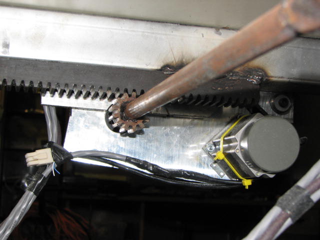

    edited 2007-06-18 22:47
    Dan,
    Got a better power supply and tried your equation, with a little ajustment to it.
    It's 200 step for the motor X3 for the pulley X10 for the threads. So 200x3=600x10=6,000 steps to move Z 1". Thanks
    edited 2007-06-19 03:29
    good stuff, hope you have fun..
    i use a pulley belt setup too... 200 step motor to 15:25 pulley to 3/8-16 allthread....1920 steps/inch in full step dont forget you lose a lil torque in anything other than full step
    i'm using mach 3, great program and currently rebuilding my z axis for more rigidity.

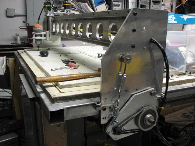

    edited 2007-06-20 03:17
    Timothy,
    Yes, the Z and X Axis are moving already, this weekend I will build the table (4' x 8') then work on the Y.
    I was loosing steps for various reasons.
    1. I was trying to move too fast. 120" per minute
    2. When using 1/8 step, I was loosing torque (as Dan mentioned above)
    and 3. My power supply was not producing enough amps to run both the controller and the motor.
    edited 2008-12-16 00:40
    $WMc%
    Thanks for the cudos !!!
    I purchase a CNC controller form Ebay, ($69) and because the table is 4' x 8' I have the BS2 receiving the Y signal and outputing it to two stepper motors on the sides (I figure that that would keep the Y axis Square and reduce the torque.)
    also the BS2 helps me find the tool position. I will post the code as soon as I am done writing it.
    (not really a programmer, lol
    for positioning I will use encoders, but not there yet; and because of that·I miss some steps from time to time.
