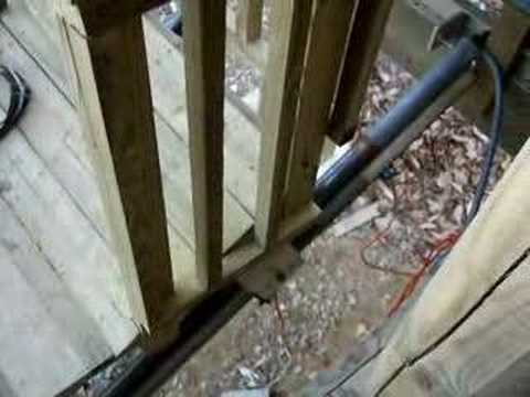

Hello,· my degree is EE and I experimented with 68HC11's in college, but 16 years of the soft life working in database programming, I don't have the tools or the skills to do what I need to do from scratch.· I'm hoping someone here might be willing to do a project for me provided I can afford it, lol.
My dad and I built an inclinator at our family lake house.· This is a cart that runs on pipes that lowers people, supplies, etc 150 feet down the hill at 30 degrees slope.· It works great, using a motor controller driving a 3 phase VFD 3 HP motor.
My issue with this inclinator is that I would like to have some kind of safety such that if the drive shaft snaps, and the spools "free-spool", there is a way to detect it and trigger a brake of some kind.

I'm trying to find an easy way to measure RPM and if a certain RPM is exceeded, give an output that I can drive a relay.· From that point, I can come up with a way to activate a brake or whatever.
The spools rotate at about 30 rpm at current max speed.· At 35 rpm, I'd like to activate something.· I've looked for easy ways of measuring this, but I think using a stamp may be the best way.· But, I have never worked with them and don't even know which controller to start with.

    If you were to have 2 mechanical brakes on the cart·held open by the tension on the main cables (one for each cable) - if one of the cables were to snap this leads to the corresponding brake being applied - The motor drive unit should have an overload - if the brake was applied due to a cable snap - the motor contactor overload would trip as it would be in overcurrent trying to pull the load against the brake. A further safety is a 'light curtain' at the winch stage (number of sensors looking at the cables) if there was a snap the cable would drop out of the 'light curtain' triggering 1)A motor shut off. 2) The tension is lost on the cable - so at the cart the mechanical brake is applied. In·the·Up cycle·case the motor would be shut off either by overload (due to brake applied on cart)·or by no cable in the 'light curtain' - which ever happens first.On a down cycle .. the motor overload will probably not trip .. but·loss of a cable in the ·'light curtain' will shut off the motor.The important thing is that the brake is always applied on a cable snap.I noticed a hand held also - an EMO button to kill the winch motor on that control .. also on the cart you could employ a 'dead man pedal' this has to be engaged·to release the brakes·even if the rig is optimal..... I think that no matter what is done here a mechanical brake is a MUST ....

    1. The car has to be able to grab the rails and hold itself with full load and at full speed. Say both cables broke on the way down with all hands onboard. Alternatively, a third cable whose only purpose is to catch a runaway condition. It would normally run under very light load and be locked if the cable speed went too high. (mechanical overspeed trip device). It can be rigged on pulleys top and bottom and run up the track bed "clothes-line" style. From experience, its not likely the gearbox is going to fail and let both spools run away.
    2. You can detect a break in one of the cables at the winch end by having a lever-type limit switch held in the "on" position when the cable is OK. If one or the other breaks, the lever moves and opens the winch-motor circuit. Also, are there mechanical limit switches at top and bottom just in case the remote stops working ?
    3. I realize this is probably going to be used only by your family, but there are a couple other safety issues. One is, as demonstrated in the video, the possibility of someone extending their legs thru the rail at the front and being jammed against the concrete at the bottom. Same setup as the car approaches the main cottage.....several pinch points between railings of the car and cottage.
    4. Once you get the car to be able to hold itself on the rails, having an emergency stop or even a dead-man control on the car would be wise. Or, at least some way of detecting that the remote has stopped communicating.
    Detecting rpm is easy with the stamp and some sort of switch, photocell or Hall effect sensor watching the spools go around. But, the last thing you want on an outdoor, seasonal use device is a safety system dependent on electronics. Even after 40 years in the electrical industry, I must admit there are some things best done mechanically!

    Quattro, very valid points. The cables are seperately connected to the cart. Each cable supports 17K lbs so I have 2 in case one breaks. We considered a deadman switch also, but since the cart is sometimes empty (as in that 3rd video) that would require someone to lock the deadman in place, which could defeat the purpose of it. There are buttons on each end of the run to recall the cart as well as a hand held remote.
    We've really been looking at the tension holding the brake solution too, but when empty the tension isn't very high, and also, due to the length of the cable run, a free-spool condtion could still have tension in the cables due to drag.
    The motor does perform a shutdown if there is a surge. Before I got better wheels, the cart got hung up for a bit, and when it released with a hard jerk, the motor got an overvoltage condition and shut down.
    This is why I would like to have some way of measuring the RPM of the spool and can execute a spool brake if it exceeds a certain amount. The shaft the spools are on is 1.75" and I can install a shaft brake, but I need a way of determining when I need to do it, thus my original post.

    1) yes, this is something I have strongly considered, but my concern is how to determine an overspeed condition. The likelihood of both cables snapping is pretty remote, IMO. I have a max load of (500lbs+200lbs)*sin(29)=340 lbs on the cables (static, anyway) and each is rated for 17,000 lbs. It's nice to hear that your gearbox experience says its unlikely to snap, but that’s the condition I'm worried about, the achille's heel of this device, imo.
    2) I considered this also, but the wire rope is pretty stiff, and even layed out (when near the bottom) it would be difficult to detect slack in the device. There are actually 3 switches at each level. The first one 10 feet from the end activates a slow stop. The other two near the very end are e-stops. One is a system shutdown switch and another activates a full brake mode. You can see a demo of it in action here:
    3) I get a lot of comments about this. The clip with my daughters was before I had pickets on the cart. When Julia had her legs hanging down in the front, she was still a good 4 feet above the rail. Near the top, there is a good 12 inches between the cart and the deck. The only time it was a risk was when I had my head hanging over to check out the wheel action and the deck almost hit my head. I don't do that any more [noparse]:)[/noparse]. Valid points though!
    4) As I was telling Quattro, this is like an elevator in that you can recall the cart from the top or the bottom (empty), so a deadman switch would be hard to manage.
    I agree, if I had a perfect mechanical solution that would be preferred. Or, if there was some kind of simple electronic method, such as a device that produced a voltage proportional to RPM would be good too. I am able to provide a protected area for the device.

    So the mechanical aspects have been well thought out by you already... So you want to engage a mechanical brake at the winch stage incase of a free spool event (gearbox failure) So you are looking at a basic stamp 2 ?? Using a command like 'pulsein' reading the frequency of a pulse derived from a sensor looking at the winch pulley (sensor - reed or optical - the choice is yours) .. would this be a fair assumption ?

    Yes, that is what I'm thinking.· Preferably some kind of sensor that is pretty reliable.· I had to do a project in college using photosensors to guage what kind of coin was dropped in a slot.· It worked, but wasn't always perfect.
    If there was a way to do it with just electronics, I wouldn't mind that either.· Hard to find off the shelf items for something like that.
    Once I'm able to determine the condition is met, there are many ways I could stop the thing, such as a brake caliper and a hydraulic pump or the like.

    Bob, I did look at a clutch brake setup at the top (on the spools) but even with another parallel shaft below geared to spin more (2:1 ratio or more) we wouldn't be able to get a centrifugal clutch (like go-cart) to activate.· They need a minium of 1200 rpm, and the current base speed is 30 rpm, so the gearing may prove to be too much.
    The problem with doing the mechanism on the cart is that the wheels are basically casters for smooth operation.· Getting traction with a wheel/axle would be pretty difficult the way it works now, and a wet steel rail could mess that up.
    ANOTHER PROBLEM DISCOVERED
    The CW would be another good solution if implemented, because this weekend we discovered another issue.· When there is too much load on the cart, the motor controller is stopping with an OBF fault which is an over-braking fault.· Basically, the cart when it goes down is in regenerative mode and the back current exceeds a limit and causes a shutdown.· The fixes are to lower the HSP (high speed value) or reduce the number of people on the cart.· The motor controller is a 220 volt 3 phase VFD and is pretty cool.· Fairly programmable in terms of basic settings, max speed, ramp up, ramp down, etc, but not as programmable as a stamp.
    My dad who helped me build this thing and did all the motor controller work said we need a brake resistor to fix this problem.· It is a 5 ohm resistor that handles 500 watts.· It's about a foot long wire wound ceramic.· We'll have to build a cage around it to prevent anyone touching it.· It only activates when there is back current.
    The CW would reduce the back current as would any other method of resistance, but the work involved is fairly daunting, even if I only do a 1/3 or 1/2 track and gear it with pulleys.· The long term maintenance would be an issue too, more cables to replace etc.

    Lots of proposed solutions to your safety need for a snapped drive shaft / free-spooling problem.
    But, what are the various failure points in your system, and what are the various likelihoods (hard to determine, no doubt) of each failing and creating a dangerous situation for the passengers?· --broken drive shaft? broken cable? failed clevis? derailed cart? no electricity for main or backup safety circuits? failed end-of-trip off-switch? cracked rail pipe? etc, etc....? Is the drive shaft failure by snapping your single largest risk?
    (I noticed that you installed railing balusters on the cart, after the first video --the one where your daughter(?) hung her legs over the front edge of the cart's floor towards the bottom of the ride: good way to have your legs involved in a crushing accident!. That was a good safety feature.)

    PAR, Yes, I believe the broken shaft to be the most likely point of failure at this point.· There could be at least three things to cause this:· A broken shaft from motor to gearbox, a broken shaft or stripped gear inside the gearbox, or the mating flange that joins the spool to the gearbox.· The other items you mention have been accounted for, 2 cables (each capable of 17K lbs) attached when only 1 necessary, the rail is 1/4" thick pipe wall (2.5" pipe) and is welded all together as a single unit.· If it derails, its a 4 foot fall to soft earth.· In a power loss situation the system freezes solid.· For the failed "ramp to stop" trip switch (my biggest concern at one point) was a push plate at the top that hits the E-Stop that does a very fast shutdown.· In one of the Utube posts above I show a demonstration of the switch minus the push plate.
    Yes, the balusters were always part of the plan.· The vid with my girls was the first weekend we got the prototype working.· Her legs were actually about 4 feet above the rail at that point, but on the sides there was a potential for personal injury.
    Its funny, most of the possible points of failure go through your mind when you are riding it.·

  • jeffjohnvoljeffjohnvol Posts: 197
    edited 2007-04-16 19:51
    I have been looking at the 24 volt version which would work well for me because I already have a 24 volt bus in the main controller (see attached drawing in earlier post)
    http://www.parallax.com/detail.asp?product_id=30064
    It also has 10 digital inputs and 8 digital outputs which would be plenty for me.
    I guess right now though is that my problem would be the hall sensor. First off, it will be about 20 feet away from the controller (is this a problem?) and as the spools start moving, the accelleration time of 6 seconds may cause a pulse to be missed if its too slow. As I read it, the BS2 can only measure a max pulse width of 0.13107 seconds, so I may miss one or two. Not a big deal for RPM measurement, but if I wanted to determine where the cart is, it could throw things off.
    Also, is it possible to determine if a remote switch was hit twice within a 2 second interval? The FAQ says there aren't any timers, so is this even possible?
    Thanks.
    Jeff
  • kelvin jameskelvin james Posts: 531
    edited 2007-04-17 06:16
    I still think your best bet is the centrifugal clutch brake. You can use a speed increase gear head to bring the rpm activation down to a slow speed, approx. 50 to 60 rpm.
    edited 2007-04-17 06:46
    In principle, you have the same problems as an elevator.
    Having the Counter Weight to compensated for at least dead load [noparse][[/noparse]and maybe a minimal live load of one human] reduces other design parameters.
    A purely mecahnical brake system for a runaway seems to be also a must as that mode of failure is sometimes precipitated by a power failure.
    If there isn't enough friction in the rails to stop the carriage; the cables have to provide the braking. In that case, larger or redundant braking cables are indicated.
    Having a 'crash absorber' at the bottom is a good idea too. Either large springs or other shock absorbing devices.
    Regarding safety issues, the electronics engineering is secondary to the mechanical.
    edited 2007-04-17 13:03
    Kramer and John, Thanks for your input. I'm not debating between a mechanical or electrical brake, but rather a mechanical or electrical method of determining an overspeed condition. I know there are very expensive centrifugal braking systems that exist in the elevator world, but I'm somewhat limited to what I can build, and I think electrical measurement is more dependable than mechanical given my current conditions of what I can reasonably construct.
    I can monitor periodically the operating state of a stamp, and could even test it by putting a magnet on a disk and running it past the sensor to see if the brake is applied properly.
    I also think, imho, that it would be just as secure to apply the brake to the spool rather than the cart. At the spool, I have a fixed position and plenty of power there. Any powered solution on the cart would require much maintenance (recharging, etc). I understand what you say about a power off condition would trigger it, but that would require I turn it off sometimes to save battery, and I think it would take to much juice on even a car battery to release the brake each time.
    A loss-weight activated spring brake was strongly considered as well, but things can rust and/or get stuck over the years. There would be increased maintenance and imo, more potential points of failure.
    The cables are way overkill. A single cable can handle things easily (2% at max load), and we have an extra cable as a backup. I have a friend who is a mechanical engineer that has reviewed my setup. He agrees with me that the brake should be at the head unit.
    We are considering a backup of an emergency pin to pull to drop a spring loaded anchor that stretches a few garage door springs (with a cable limiter inside them) as a manual emergency stop.
    A crash absorber at the bottom is in the plans, that’s a very good point.
    Thanks.
