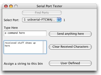

    Included is a REALbasic file that does just what you want. It is shown as OSX, but if you go to realbasic.com you can find a PC demo, it will load the file posted and you can test it out. I haven't used Python, so I can't compare it. I really like REALbasic though, there is a pretty good forum for it where you can get answers really quickly, the tuturials are great too. I use if for GUIs for Propelller projects all the time.
    This app looks terrible, it is just a serial port tester, you can get as fancy as you want with the program and graphics.
    The command to write a string to the serial port using the User Defined button shown is as simple as this:
      Dim OutputString As String
      OutputString = "1"     'change this to your string
      Serial1.Write outputString

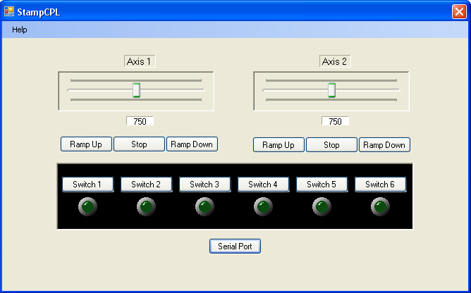

    Hi Cobalt, when I was wanting to create a GUI to go with a Stamp I didn't realise there was so much choice. I had an old copy of Visual Basic so thats where I started. Then I downloaded and started using VB Express when I discovered it was for free.
    Like Kramer says it is unlike Parallax basic but what helps are the thousands of examples and what they term "walkthroughs"·which makes learning easier, so VB express is what I use.
    I don't know a lot about the other programs but if I wasn't into VB I might opt for Real Basic from what I have seen the graphics of the interface look good.
    I am not an expert with Visual Basic but if I can give you a few pointers that might help let me know.
    Jeff T.
    this is my·SS of a two servo controllers with 6 switches used as inputs or outputs.
