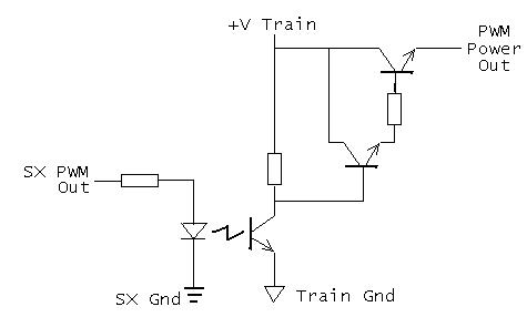

    Wondering about running the PWM from the SX into an opto-coupler (4N..) --·isolate the SX electronics from the train·voltage/s altogether·(no shared Grounds or anything else, here.)·
    Even better, one of those hobby fibre-optic kits (with the plastic light "fibre"), you could get several feet of separation.

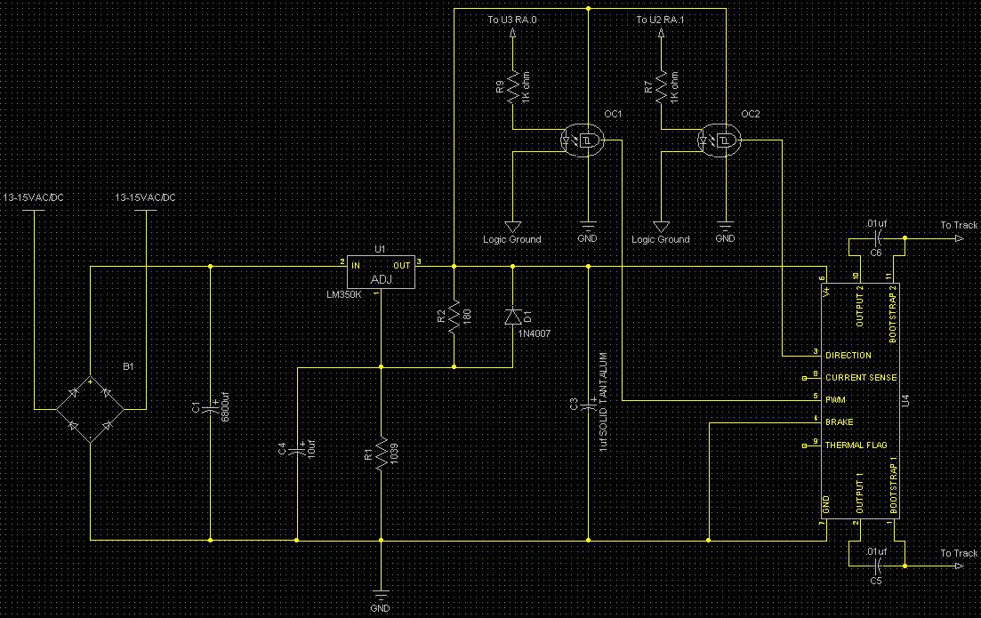

    What optocoupler do you recommend I use?· I have a schematic for my plan (see attached).· The Absolute Maximum Voltage·Rating for the PWM and Direction pins·is 12 volts.· Is it a good idea to use 12 volts on these pins, or should I use a lower voltage, or put a resistor between the pins and optocoupler detector?· Note, the LED is not connected; however it will be attached to my logic ground and the output of the sx.

    I like the opto coupler idea better.· I have a revised schematic.· The logic portion and the locomotive supply portion are completely seperate, their own grounds and everything.· The only connection is the optocouplers.

    Lightfoot,
    In your schematic, the photodiodes in the optocouplers are wired backwards. Also, the 100K resistors on the phototransistors probably ought to be a lot smaller. Even then, though, I doubt you're going to be happy with the PWM performance. The reason is that phototransistors, when used in voltage mode as you're doing, switch very slowly. I don't know what your PWM frequency is, but if it's over a few hundred Hertz, you won't see a clean squarewave on the output of OC1 — especially at the duty cycle extremes. You might take a look at a different kind of optocoupler. The H11L1, for example, has a built-in Schmitt trigger and switching times in the microsecond range.

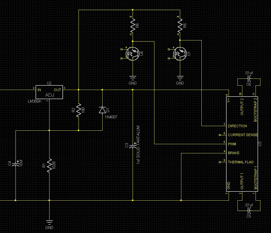

    Here is the·revised locomotive supply portion of the·schematic, good thing you caught that, thanks.

    I am using this command to PWM my HO trains.
    'The rb bits specify the duty cycle.
    PWM RA.0, rb, 1
    In other applications I used this code to PWM.· My model train locomotives respond well to it.· Is this optocoupler fast enough?

    Be sure to add pullups (2.2K) to the H11L1 outputs. Even though they're logic-based, they're still open-collector.

    Am I OK with the switching speed?
    edited 2007-03-26 17:20
    You'll just have to try it. I don't know what your PWM frequency is, but you won't be able to do better without spending a lot more money on isolation solutions.
