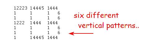

    ·. but how about the example below.· I might latch the rows across (freeing up computer pins) then use fifteen pins to illuminate the vertical·columns, one pattern at a time...· (all of the 1's, first, all of the 2's second, etc...)
    ·attachment.php?attachmentid=45402
    .·in the above sample - doing each of the six patterns consecutively would end up with a 16% duty cycle.
    . . . would it flicker ? --·the·month, "JAN" would need nine patterns -- what is my limit there ?·- certainly not all fifteen ? ! ?

    Most displays that handle text work this way. Most video (TV and VGA) use some variation of the same thing (a dot matrix display). Typically, you have a font table with 5 bytes for each item in the table. Since the most common ASCII characters run from blank (32) to "~" (95), you typically need 64 entries in the table (for a total of 64 x 5 = 320 bytes) which is stored in EEPROM. Each byte is one column (with the 8th bit usually not used). You simply have a couple of nested loops, the outer loop goes through the characters of your message. The inner loop goes through each of the 5 table entries for the selected character and outputs the 7 bits (for the column being displayed). You could use a 4 bit decoder/driver to drive the display columns with one bit combination (%0000 or %1111) not connected so the display will be off. This 4 bit value would be incremented for each table entry and character (3 x 5 = 15). If you do these nested loops often enough, you'll get a nice 3 character display with no noticible flicker.

    . okay.· thanks.· again, the scheme isn't the problem - but you say,
    Mike said...
    use a 4 bit decoder/driver to drive the display columns...·· ...(3 x 5 = 15)...· one·not connected...
    · which to me implies one of the fifteen columns at a time will be illuminated (with a pattern from the table)...·· for a duty-cycle of only 6%· -·· will that be enough to fool the eye...?
    . well, I can make printed circuit boards, now.··and twenty minutes with my drawing program will be sufficient to "wire up" a test board.· If it called for hand-wiring, I wouldn't even consider experimenting...····· I can socket the 5 x 7·matrix blocks...
    . AND ---> one column at a time·(per matrix, at least) may be the ONLY way I can do that - in order to have only just ONE lit LED per horizontal row - and so be able to supply the very same amount of current to each LED.· Forget (!) my patterns up above - I wouldn't be able to get consistantly even illumination.

    You may end up needing external drivers. The ULN2803 Darlington arrays are simple to use. You'd need two packages (for 16 drivers). They ground the output so they'd go on the column lines. You'd need PNP transistors on the row lines. For testing, limit the current to the maximum steady state current for the LEDs. Usually 10-20ma is typical. Once you have this all working, you can decrease the current limiting resistors to make the peak current 7 x 10-20ma = 70-140ma (that's why you need the external drivers). The current limiting resistors would be in the row lines so the LED brightness would be set by the resistors (since only one column is lit at a time).
